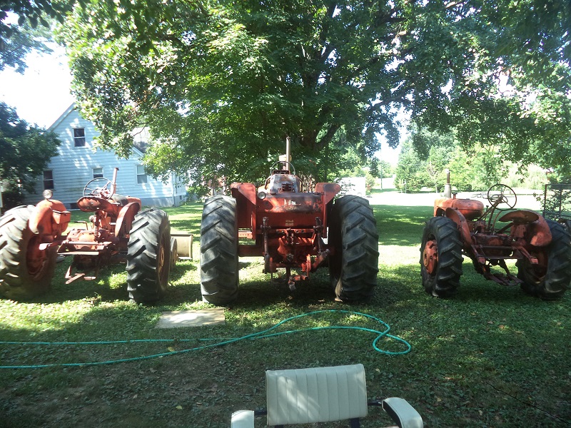

The tractor on the left is my WD45 with 16.9x28 Armstrongs on 12" rims. The tractor has worked liked that since the 1970s albeit the tires previously on it (unknown brand) did look more normal than these L/S bar tires do now.
