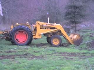

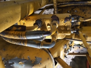

Finally got some pictures to work. Still could not get it to rotate the way i wanted but I got them on here. Has anyone ever had a problem with the poppet valve/PSV not holding? I works good when idle but if I push the throttle up and I go to use the loader or backhoe it looses all power until I drop it back down to idle and move the font loader to get the power back. I have changed the hydro fluid and filter and it all looks good. but when it does it. It sounds like its bypassing in the lever valves. That's what makes me think its the Poppet/ PSV valve and not the pump. Thanks for all the help i can get.

OK, now that I see the valve, in question, it is not the same as what I thought. I'll dig around my manuals, and see if I find anything, on this...
You may find it ea$ier to replace the whole valve, with a off the shelf unit, from surplus center, or a similar supplier...Wink
