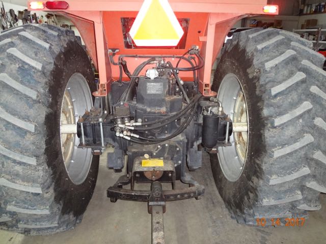

Tornado do you have a picture of your couplers after you changed it

I ask because I'm looking at a 8050 and it has lever type and it has wire tie around them, and couplers look different then others IV seen with lever type
