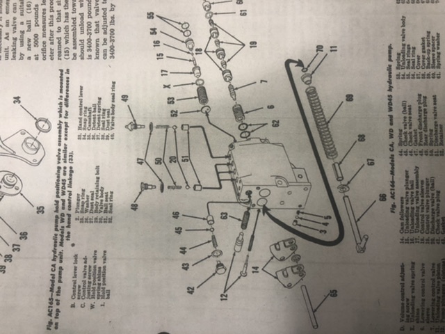

Post Options Post Options   Thanks (0) Thanks(0)   Quote Jareddrew82 Quote  Post ReplyReply Direct Link To This Post Posted: 25 Nov 2019 at 5:44pm
. Numbers 51 and 46 are parts in question!

Post Options Post Options   Thanks (0) Thanks(0)   Quote Sugarmaker Quote  Post ReplyReply Direct Link To This Post Posted: 25 Nov 2019 at 5:54pm
Jarred,
 Ok I see the two parts you mention and I do not believe that have removed those seats. Item 51 or item 46.
There are a bunch of parts in these. I am always a little intimidated. I would rather tear into the engine than one of these!:)

Post Options Post Options   Thanks (0) Thanks(0)   Quote Jareddrew82 Quote  Post ReplyReply Direct Link To This Post Posted: 25 Nov 2019 at 6:11pm
After reading the service manual and reading several forums I do believe they do not come out! So good cleaning and o-rings and hope it works! Thanks for responding Chris

Post Options Post Options   Thanks (0) Thanks(0)   Quote MACK Quote  Post ReplyReply Direct Link To This Post Posted: 25 Nov 2019 at 9:06pm
No need to remove seats. If you do want to remove them, use a fine thread tap to thread them then use a slide hammer to pull them.      MACK
