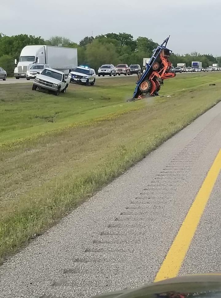

This guy KNOWS how to tie em down. Just maybe forgot the safety chains on the hitch.

Best comment on Facebook; he sure STUCK the landing Big smile

Wow, did you see that or is it a repost?

That’s the way to do. I seen a guy last week that had a car just rolling back and forth on the trailer. He only had 2 straps pulling the same direction that were loose, Very scary!

I'd be angry with Kubota, the hood latch failed ;)

Instead of an improperly secured load it is an improperly secured trailer.

...or chain.

I would bet the tail wagged the dog.  The safety chains on a trailer are meant to cradle the hitch should it hop off the ball, not keep the 2 halves together when the trailer starts whipping like mad. That said, none of us know what failed as I haven't seen an official post stating why.

There doesn't seem to be wheels/tires on this side of the Trailer. One looks like its laying in the median. Maybe he lost a wheel or wheel studs? The load stayed right where it was supposed to stay though.....

Scary! That truck is exactly like mine! And I have a trailer like that hooked behind it right now. Better say some prayers......

I just read what happened in a Facebook post.  Tail wagged dog, truck rolled 3 or 4 times into the ditch.  They don't know how or why the tail started to wag.

Not enough tongue wight, I have had a trailer or too that felt loose. Nott fun. The loader bucket should have been on top of the rack and tractor forward on trailer. Hope he recovers ok.

Or it should have been backed on the trailer.

I agree - not enough tongue weight, and it appears to be some piece of equipment on the rear of the tractor.

Know two fellas will NOT hang safety chains, told them they had better be broken if trailer comes loose as their insurance is liable where they may deny coverage, one decided to start using them, the other refuses. I have safety chain on EVERY trailer I own, use them religiously, trailered the 180 with loader with a 3008 Bush Hog on it many times, knew it would explode chains in a roll over but had it lashed tight!!

There's no excuse for not using safety chains. That's just being stupid!! PERIOD.  Around here, the law enforcement always checks Trailers for safety chains, breakaway switches etc. No reason in Hell not to have ALL the safety equipment while towing and have whatever your towing tied down correctly. Could save your life as well as other innocent lives while rollin' down the road at the high speeds people travel.

Wag the tail is what happened. It should have been backed on with  enough tongue weight to make it pull safely.

Looks like had the load as far forward as he could get without backing it on. Wonder what really happened and the cause.

APPEARS THE TRAILER IS TO LIGHT DUTY FOR THAT HAUL, AND I'LL BET SPEED HAD ALOT TO DO WITH IT!

I've never hauled a tractor with a loader..... I don't think, but if that tractor didn't have a loader the way I'd haul it on my trailer is to have the tractor positioned so the center of the tractor rear axle is just a few inches ahead of the center of the trailer rear axle. That had always worked well for me.
With a loader I'd be in favor of backing it on if the tongue weight doesn't get to be too great. It appears to me that in this case the tongue weight would be a factor if backed on but I don't know what he was pulling this load with or what was on the back of that tractor. If possible, I would have set the bucket further forward onto the trailer hitch. And I do agree, that trailer LOOKS entirely too light. Looks more like a lawn mower size trailer.
My final verdict is that the trailer was too small (short) and too light to comfortably haul that tractor with a loader.

He did use safety chains.  They were still attached to the truck.  Something catastrophic happened, the tail wagged the dog, and the truck rolled 4 times.

Guessing over weight for trailer and too much speed which will shear the lugs on the hubs. Was with a buddy that did the same thing without the roll over. A scary ride and I don't think he learned a thing about speed and overloading a trailer.

Looks like he did a good job. Regardless of what happened, if the trailer comes unhooked from the truck, whatever is on the trailer is supposed to stay on the trailer.

My wife last night showed me that picture on the Illinois State Police page for the district it was in. It said something like if you want to know how to tie down a load, talk to this guy. If you want to know how to hook up a trailer, talk to someone else.

What I saw said a wheel came off the trailer first, must be true, I read it on the internet.

Looking back to the photo have to agree, tractor rear axle three feet behind rear trailer axle, TOO short and TOO light a setup, should have backed on.
I would suspect the wheel came off from side load swinging sheared the lugs.
