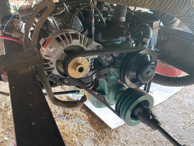

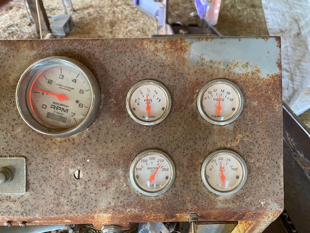

Together again........
Now sporing a new 90 amp one wire Powermaster Alternator from Summit Racing. Looks to be charging!
Once that bolt came out, it was clear sailing. Having said that, this turned into bigger project than I expected. In no particular order.......
1. Upgraded battery cables to #4....upgrade charging wire to #6.....hot and ground.
2. Installed new alternator, which required specific alternator brackets to match old cast iron water pump. Those took some looking to find. Also....now running on two new fan belts.
3. New double roller timing chain and timing chain cover. Found and installed an oil slinger on crankshaft behind the big pulley. It was missing the slinger when I pulled it apart.
4. Pulled oil pan to clean out the sludge. So all new gaskets, front and back.
5. Installed new dip stick tupe into the block (that wasn't easy). As near as I can tell, it's half inch or so longer than the old, and came with the extra long dip stick needed for this jumbo sized oil pan. So using the shorter dip stick tube that was on the engine, I may have been running half a quart to quart low all along. That's not good.
5. Pulled and rotated distributor to get it in synch with timing marks.....then swapped out all the plug wires to match correct firing order. (Distributor had been installed backwards, so instead of fixing it, they swapped plug wires to match).
6. Found a harmonic balancer to get crankshaft to Top Dead Center for #1 cylinder, then installed the big 4 pulley replacement, and put timing marks on it (there were none).  All that thru the timing off, but she did start....but ran ruff. Trial and error got her running great........needs to be fine tuned with timing light or vacuum gauge.
7. New crosses for U-joint that runs hydraulics.
8. Swapped engine temp sensor from water pump to correct position on top of engine block, so reads correctly.
9. Hard to tell from photos, but also painted all those parts. Paint job marred by all the sealant and anti-seize smeared all over everything.
10. Removed old insulation around fuel line from pump to carb. Replaced it with an aluminum / glass heat shield fabric tube. Old insulation was burnt off where it ran too close to the exhaust manifolds, so bent it a bit to give it some space. That may have been hot enough to have caused it to vapor lock and not start when hot.
The water pump and timing gear bolts all new Grade 8. If they ended in the engine block in coolant, they got thread sealer, plus anti-seize on the shaft of the bolt. Bolts in oil were short, they got thread sealant. Bolts in dead ends in the block all got anti-seize. next guy won't have as much trouble pulling it apart as I did.
Anyway, as noted, cranked it a bit and she started........then once I got the timing right, she ran good. I'd say she purred, but with a pair of cherry bomb glass packs for mufflers, that is more of a deep throated rumble.
Long hard road and painful lessons learned, but learned a lot and added to my tool stash.........by a lot. Hope the juice I get was worth the squeeze!

Bolt circled in green was the culprit that started all the trouble. It runs thru tensioning bracket, mounting bracket, cast iron water pump, aluminum timing cover, then into threads in cast block, but also terminates with end exposed to engine coolant.
Bolt circled in red ends in a blind pocket in the engine block. It is the main support for the alternator. When tightening belts, tendency may be to loosen the problem child bolt too, but if you do, that would break the seal on the thread sealant......maybe now a leak.  One just has to remember to never, ever touch that bolt. The bolt in red and tightning screw on the alternator......and nothing else.

Keep on eye on that alternator, the belt appears to ‘riding high’, the pulley may be too narrow. The top of the belt should be level with the top of the pulley grove.
