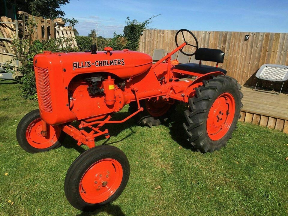

Hi All, New to the group, as I have just purchased a 1948 Allis Chalmers B, that need a little work.
I am needing two new Rear Wheel Bearings, has anybody a make / part number for these, or the sizes and description.
I am wanting to order the spares before I remove them ideally.

Rear Axle/Final Drive:
Axle Seal- CR #25043
Axle Speedi-Sleeve - CR #99248
Outer Axle Bearing Cone - Timken #368A
Outer Axle Bearing Cup - Timken #362
Inner Axle Bearing Cone - Timken #14138A
Inner Axle Bearing Cup - Timken #14276
Bull Pinion Seal: CR #13900, National #450456
Bull Pinion Bearing Cone - Timken #14138A
Bull Pinion Bearing Cup - Timken #14276
Transmission & Differential:
Differential Carrier Seal - CR #11343, National #410163R
Differential Carrier/Bull Pinion Speedi-Sleeve - CR #99125
Differential Carrier Cup - Timken #25520
Differential Carrier Cone - Timken #25580
Input Shaft Cup - Timken #15250
Input Shaft Cone - Timken #15120
Input Shaft Seal - CR #11800, National #450162 (471765)

as far as i know the B and C use the same bearings in all locations...... above is what i have used on the B.

Many thanks.
I have now ordered the parts.
