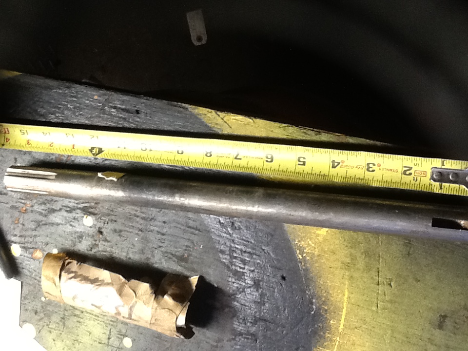

Hi everyone
Have a shaft here. Measures about 15-1/2" long X about 1" diameter and the splines on one end are about 2" long. On a tag is written D-15 loader and I think TS-500. Think it's a front hyd pump shaft
Thanks

Post Options Post Options   Thanks (0) Thanks(0)   Quote SteveM C/IL Quote  Post ReplyReply Direct Link To This Post Posted: 22 Jan 2020 at 6:38pm
Looks like one to me.

Per the Allis Parts Catalog D47 for Series 400 and 500 Loaders:
Shaft for Model 415 Loader / D-15: 343285 Gas and LPG
    for D-15 Diesel and D-14 Gas: 343291
Link to Steiner website:
Shaft
https://www.steinertractor.com/ABC1814-front-hydraulic-pump-drive-shaft?&TF=8EF74A6D4D48
Hub
https://www.steinertractor.com/ABC1812-front-hydraulic-pump-drive-hub-adapter?gclid=COLpmMSc2LgCFe9aMgodZmYAuA

Gary, the D47 parts book says also that shaft #343291 fits all 417 and 517 loaders.
It sure looks like the one in the Operator's manual for the 500 series loader for D-17 and D-19 tractors. It also looks a lot like the Ford shaft I bought on ebay for my D-17 gas.
That Steiner's shaft appears to have a larger spline than the shaft itself.
Here's a picture from the manual and a picture of the Ford pieces I bought.....
appear to be the same.

The shaft for the D14, D15 diesel and D17 is 13 in. long as is the 3/4 dia. 6 spline shaft Ford shaft. Not sure on the D15 gas.

Post Options Post Options   Thanks (0) Thanks(0)   Quote Alex09(WI) Quote  Post ReplyReply Direct Link To This Post Posted: 23 Jan 2020 at 1:36pm
THE SHAFTS FOR D15, D14, D17 400 LOADERS IS 3/4' DIA. 6-SPLINE!!
THE SHAFTS FOR D-SERIES INDUSTRIAL FRONT PUMPS ARE 1" DIA. 6-SPLINE!!
THE SHAFTS FOR 170-175 FRONT PUMPS ARE 1" DIA. 6-SPLINE!!
Now that that is straightened out, Mike, your shaft is for a D15 Industrial reversed forklift to drive the front pump, which operates the   I have a used driveshaft on the shelf that I removed from said forklift 2 months ago. The shaft is 1" dia, and ~15.25" long. I can't find the parts book for that D15 forklift on AGCO, so I don't know the part number.
Edit- I believe it would be under the I-60 forklift, NOT I-600

Post Options Post Options   Thanks (0) Thanks(0)   Quote Brian G.  NY Quote  Post ReplyReply Direct Link To This Post Posted: 23 Jan 2020 at 4:24pm
Well, ya made me go out in the cold old barn and measure the shaft I have.
13-1/16" long X 3/4" dia. 6 spline......just like Joe says.
Good thing there is somebody like Alex who really knows what he's talkin' about!

Post Options Post Options   Thanks (0) Thanks(0)   Quote Alex09(WI) Quote  Post ReplyReply Direct Link To This Post Posted: 06 Jul 2022 at 10:30am
Mike I still haven't been able to track part # for that shaft, but it is for a TS-500 loader front pump. I will send you an email as I am interested in the shaft.
