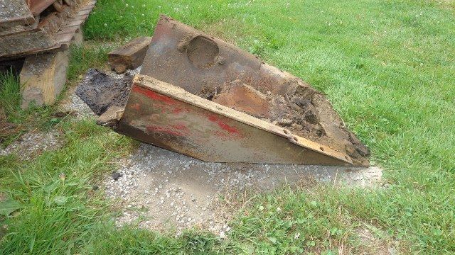

I finally got it out but what a pain. First I had to drop the pan that attaches to the side frames. This was a big deal as the pan was so full of dirt the dirt covered about half the starter. Add moisture and a temperature of 20 degrees and you get a block of frozen dirt. After I got the pan bolts out the pan didn’t drop. I had to pry it from the frozen dirt. Then I had to chisel away the frozen dirt to get to the starter and starter bolts, not fun. The dirt was a perfect mold of the pan. Frozen around all the cables and hoses. The next issue was getting the bolts out. The bolt heads were all 12 point and all a different size. Normally that wouldn’t bother me but when you’re 6’-4” and have to enter weave my body with the frame of the blade it gets challenging getting in and out. Anyway I got it out and putting back in should be a whole lot easier.

I dont have to take my pan off for the starter, but did drop the pan and clean it and it was in the summer so it wasn't frozen but packed with dirt too! Not a fun job! We need pictures too!

 Seems if this is first time you have had belly pan off then changing oil has not been a regular occurance as when the small trap door on belly pan is removed the dirt level is easily noticed .
 Then I pressure washed my machine a couple times a month or more often and removed the excess dirt that accumulated .

Taking off my belly pan this spring. its packed under there for sure. The access plate for the oil changes was clear so no problem changing oil on my 16. Just ran out of time this year to dump the pan. Anyone have any pics to show of when you did your particular tractor please share. I now we would all like to see them.

best way.  pull onto something solid.  use a floor jack and pump up tight, remove bolts and get out of the way lol
belly pan that is

After having trash and oil catch on fire my uncle became a big believer of washing his dozers down. This was back in the 50's with his HD 14c. But the same process for the HD21 and the FD 30.He would use a 200 gallon water trough with gas engine pump,1 1/2 hose and a 1/4 inch nozzle on it. Volume as well as good pressure.
In his early years mostly clearing brush to make farm land. So some fishing of big sticks,but the leaves and dirt move with volume. Generally did not remove belly pan to clean them up,just the little plate you remove for oil changes.

Thank you for shsrythe great belly pan pics.

thats the thing if you clean on regular basis - the debris will wash out at end near cross brace . Have done it on regular basis many years as it seems working on some part of machine is always needed ans sure nice not to have to fight grease and dirt .
 Have used a sheet of plywood and floor jack a few times also in the center of sand pile to take pan off also -
