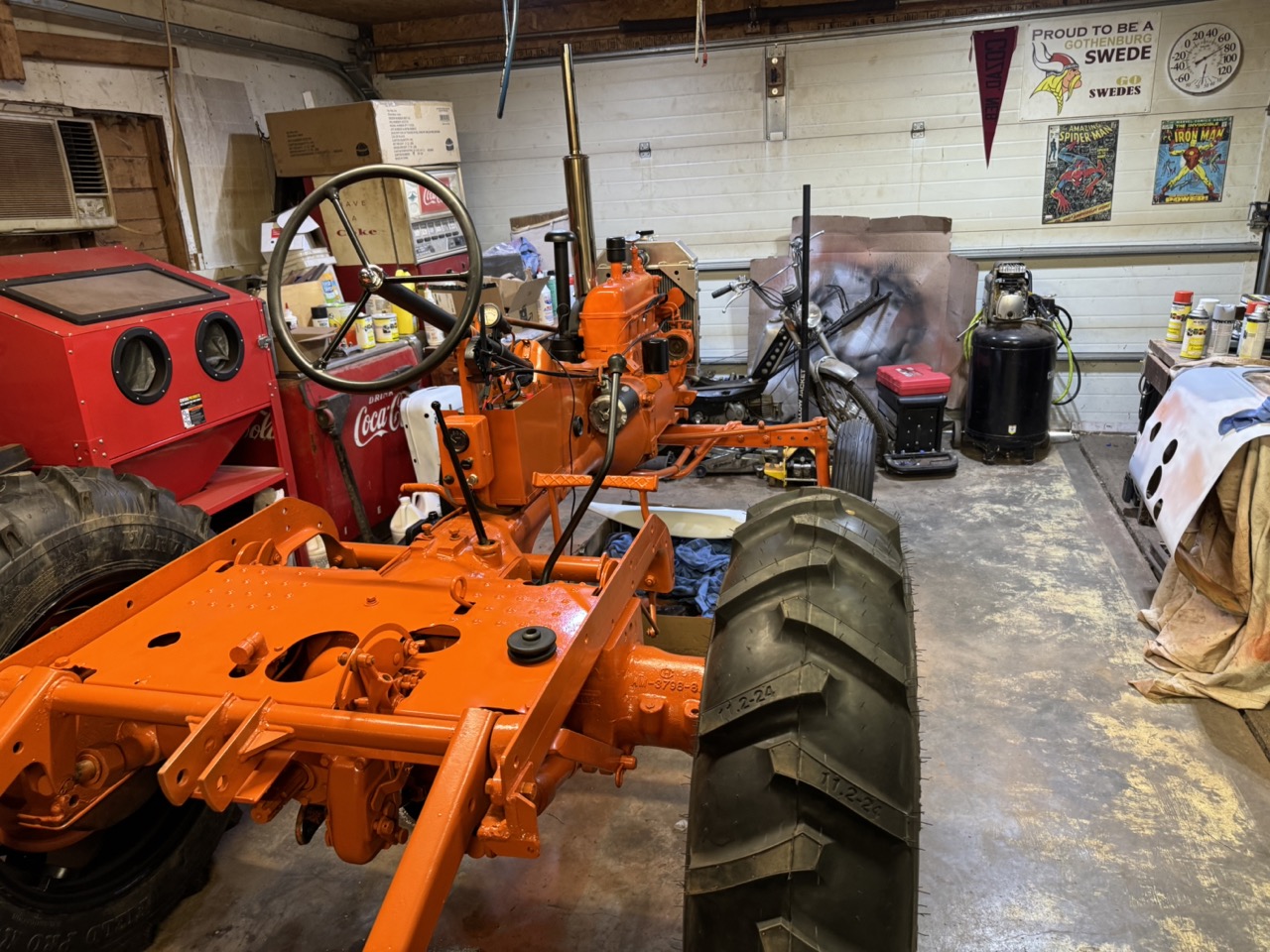

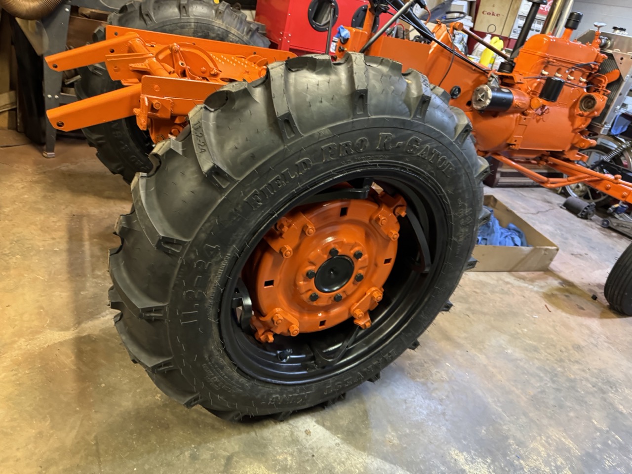

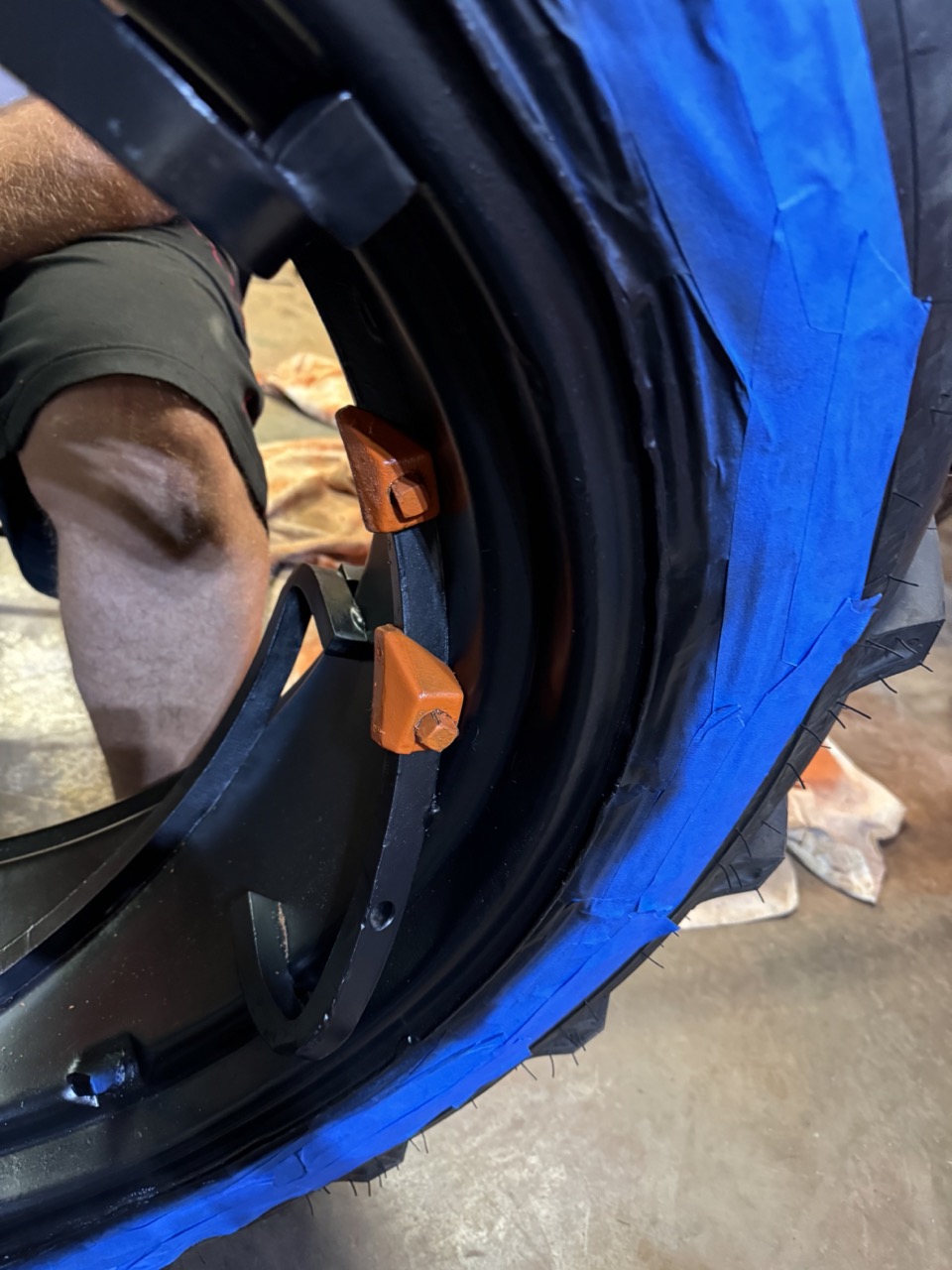

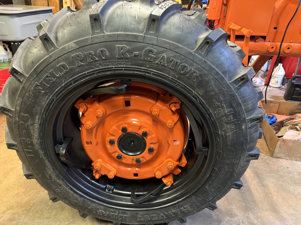

A bit more achieved tonight.  Used the drill and wire brush, and brake cleaner once again to clean up the rear final drive and etc a bit more.  Pretty much cleaned up everything except the underside of the final drive pans and the quick connect.  Will do that later when I am ready to crawl under and not in good cloths!!!
Here is the first coat of black paint on the hubs which will be black just like the front wheels.  Then we are planning to paint the rear wheel with pin body, guide rail body and pin orange.  The rim will be black.
Took the Milwaulkee Sawzall and yep cut off the tire. Was the best part of the day!!
Here is the rim. It did take a bit to pry off the remaining tire and bead off.  But did get it done with a couple of pry bars!!  Now to either wire brush the heck out of the rim or sand blast.  Then paint black.

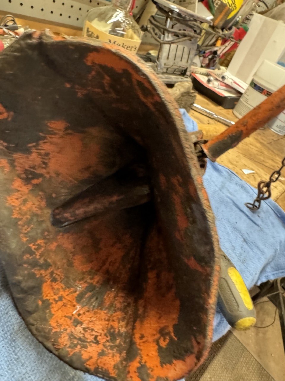

Here is the left side!!  Like WTF it is a bird nest!!
This is the seal that has been leaking which is obvious with the oil soaked birds nest above!!
More seriously, their clearly as been some wear on the seal and bearing cone housing in prior years.  Makes me think the differential cone bearing went out which resulted in this wear.  As well, I didn't take pictures (...damn) but the left shaft was hard to remove.  When we removed it had "chunks of fused metal" on the final drive shaft which you would expect to see with metal on metal wear.  Thus, we took off these ridges and cleaned them up with emory cloth.
Importantly the race and cone bearing looked good, thus, seams like we are really are dealing with old damage.  To me that is the only way we could wear the seal housing shown above and that this is not recent but old (i.e. he current seal is not worn like the seal housing.
Happy to know what other think about this wear and if there are any concerns.
Knowing that this is only to hold the new seal and the bearing race in place which is on the other side, we reinstalled both left and right seals and reassembled.

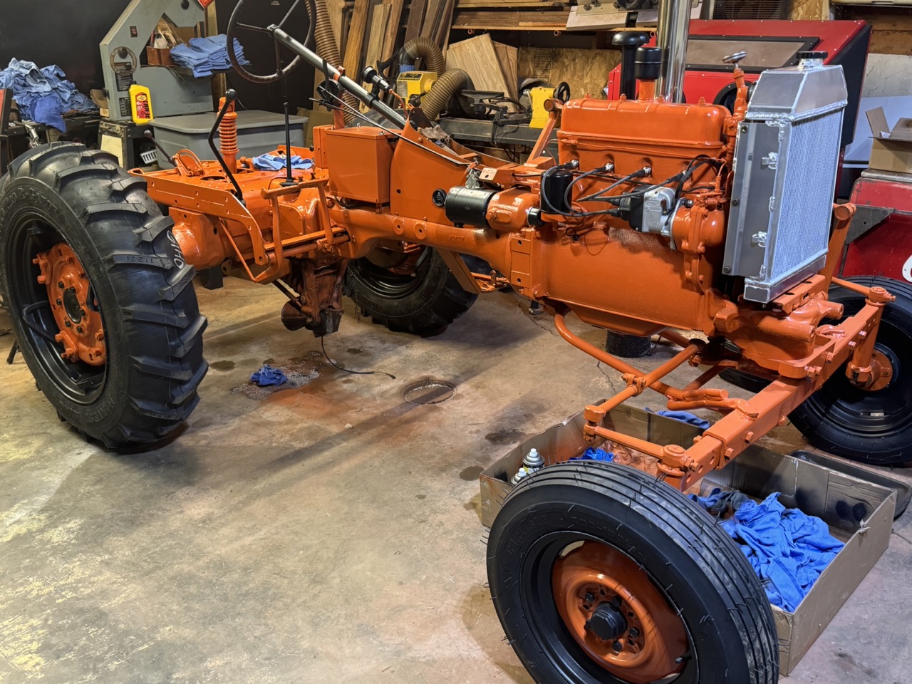

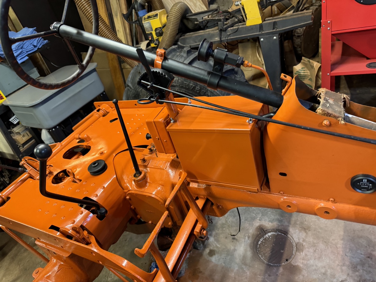

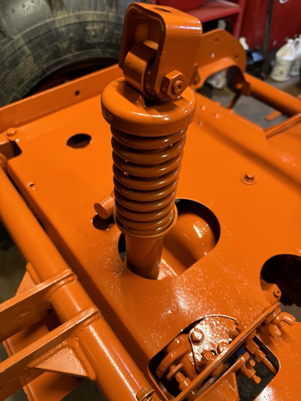

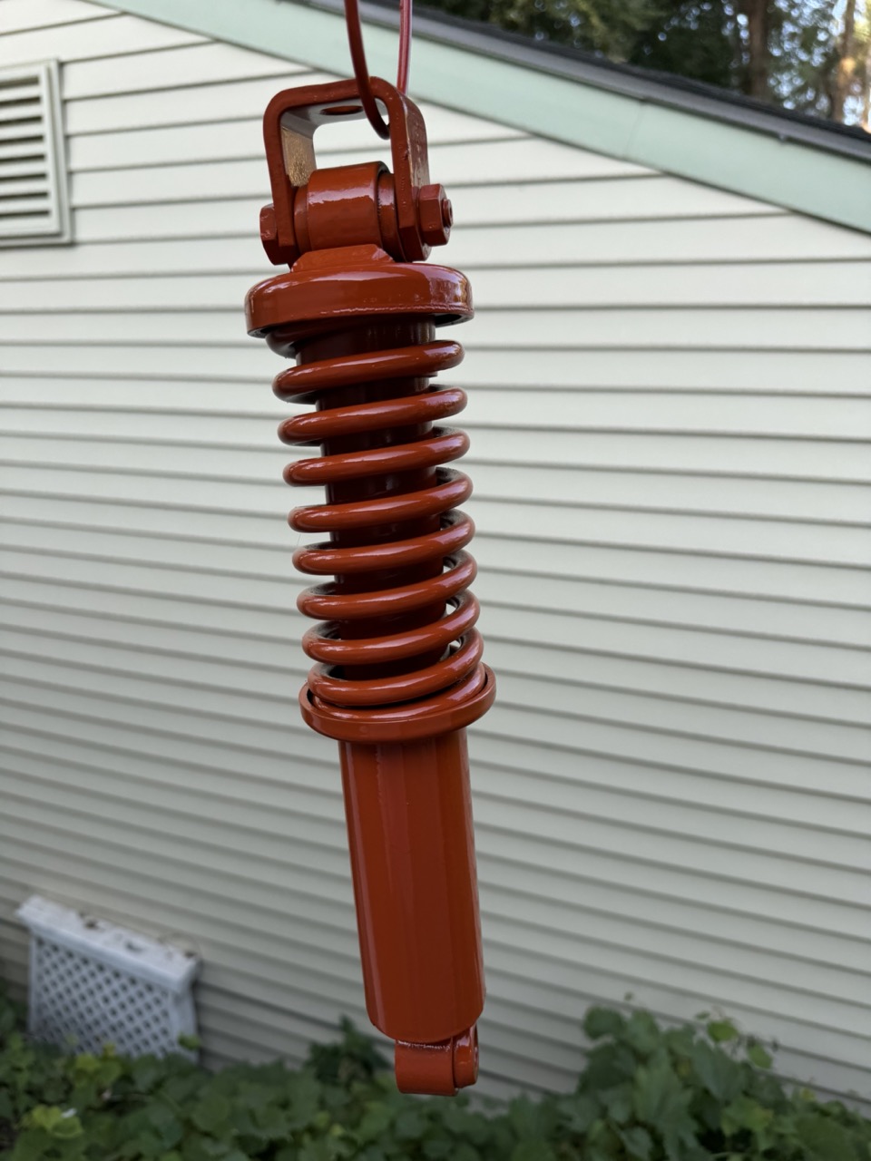

I often forget to take the pictures, however, they really do help keep track of all the effort.  As well, as I review and post photos, I write down things I need to do on my ToDo List.  Has been fun!
