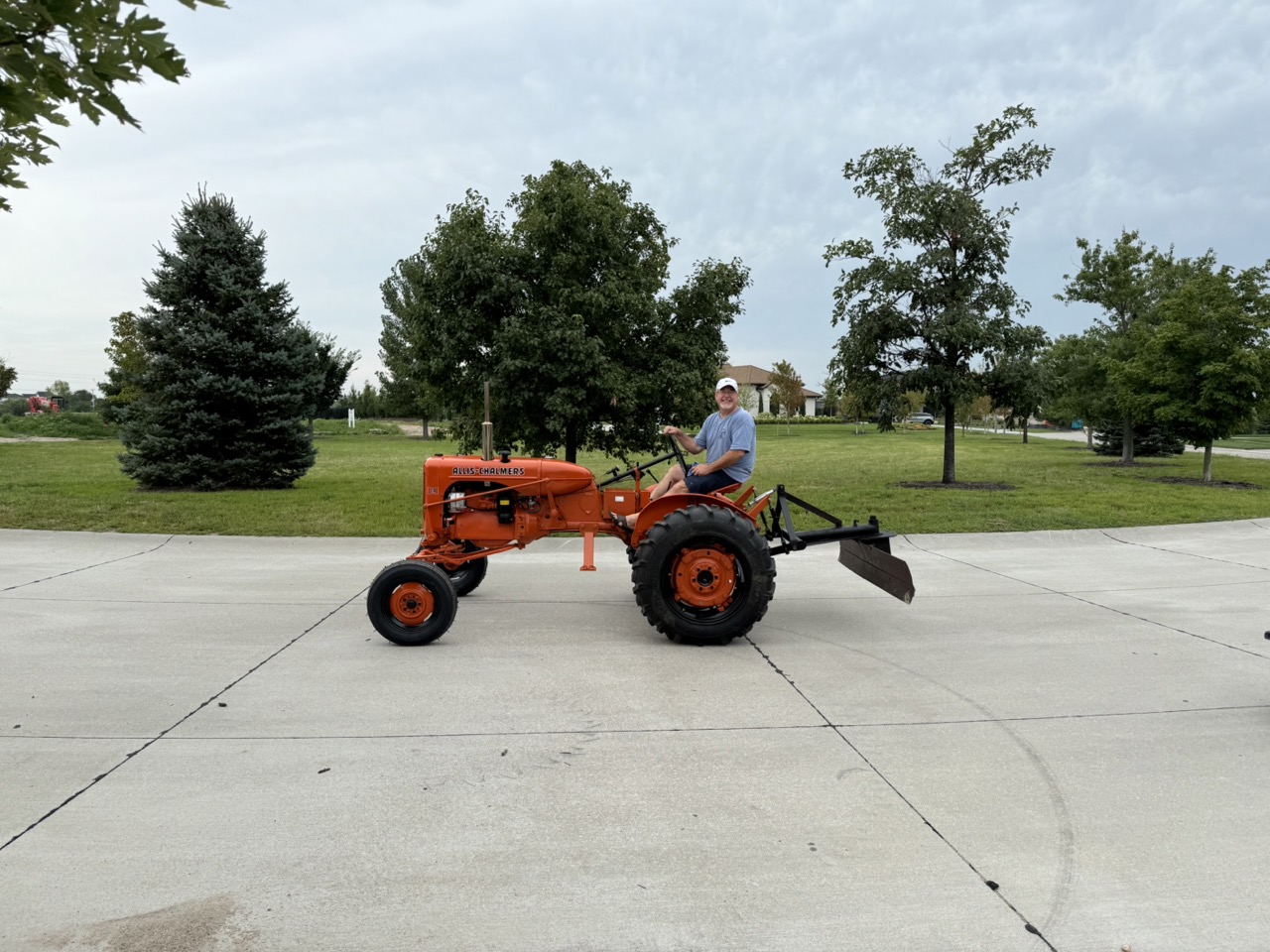

Unloaded at home.
It will take a bit to get familiar with how to control the lift and blade. I have a lot of sand to move around over the next weeks.
Here is a video of the first blade drop.

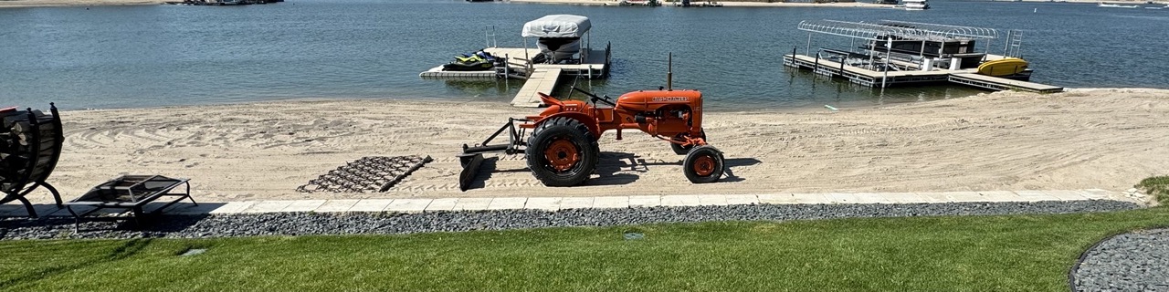

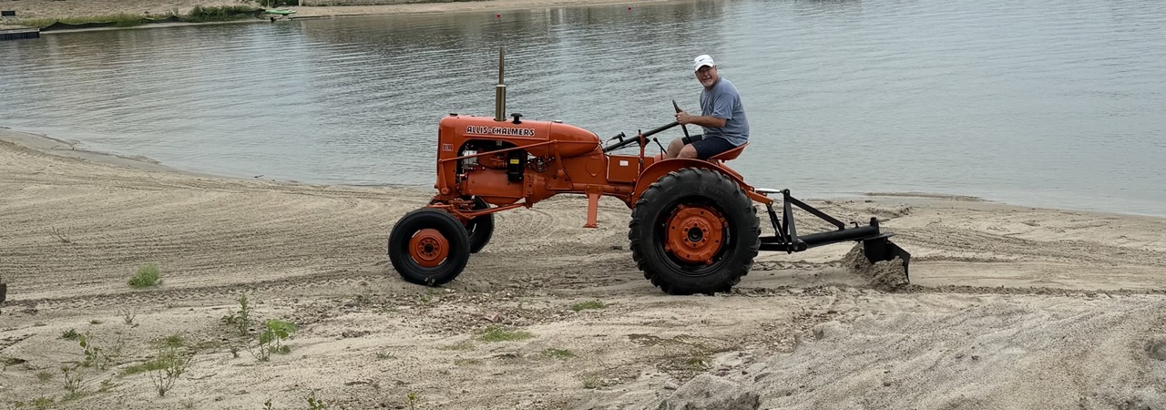

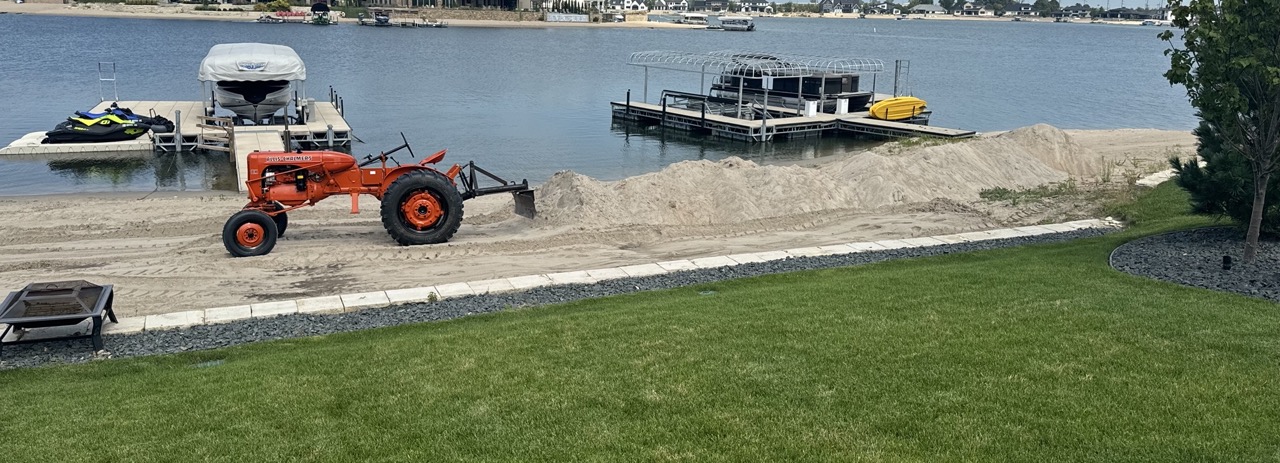

Was able put our CA to work. Moved quite a bit of sand quite easily with the 6' blade. Thought I might need to add sides to the blade to make it a boxed blade, but it worked well. I suspect I moved about 5'ish tons + of sand.

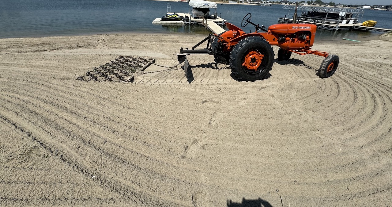

After moving the sand then used the harrow.
After about 4 hours of work. She looks awesome. I got a ton of "thumbs up" from the neighbors!

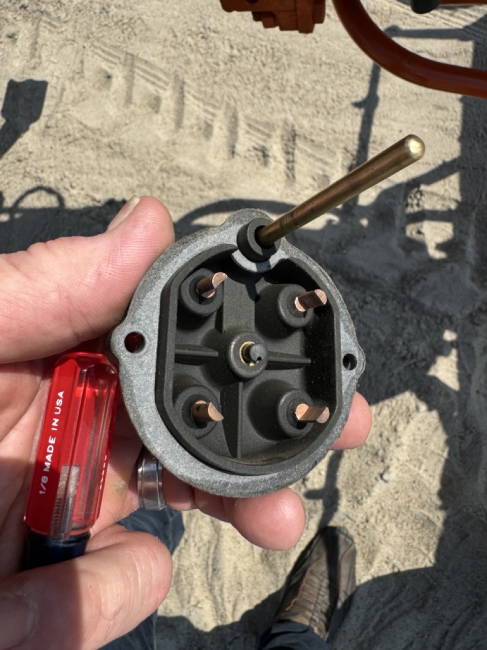

Towards the end of the day, I noticed she was running a bit off. Pulled the spark plug wires and she was not firing on cylnder #2. There was no spark and switching out the wires and plugs did not make a difference. Thus, took off the distributor cap and used a bit of emory cloth to clean up the contacts.
After that she was running smooth and even. Should probably buy some new wires, plugs, rotor and distributor cap.

It looks really good doing some work!
Yep, you'll either have to keep cleaning the cap up every so often to remove the corrosion, or get a new one. The tractor probably deserves one at this point.

Today, I noticed after about two hours of running that it was once again missing on number 2. Thus, took it apart to look. Have spark at the magneto coil but when I put it back together, nothing at the distributor cap/spark plug cables.
Thus, ordering new ones and will see what happens. Makes me think the rotor is the issue. Regardless, ordered the rotor, distributor cap, wires and new plugs.

 Very nice job on putting your new CA to work! The power adjusters are a project sometimes. At least on the WD series they can be rusted tight. But it is good to get them freed up to secure the wheels to the centers.
Sure looks good on the beach moving sand!

nice looking beach also... where is that ?

Put the new plugs, spark plug wires, distributor cap and rotor. It started right up and ran smooth.
However, was just thinking about a prior thread and how they lost spark after warming up and running for a while. I did try again on Saturday evening when it had cooled down a bit, and still did not have spark. Should've tired tonight before changing everything!

Did head out with the CA and was able to spread out the rest of the sand. Our orange friend really works awesome. Was able to pull up sand from the lake without much effort. It actually worked better on wet sand with better traction vs. the dry and loose sand I have been moving around.
Tractor worked well for about 2 hours then started missing again. Thus, I let it cool for about an hour while I shoveled some sand at the edges by hand. After that I restarted and it ran smooth again. I was back to full water temp about 10 min later, however, after about another 40- 60 min of work, it started missing again.
The magneto was hot to the touch.
I have a hard time believe this is is due to the mechanical part of the magneto. Thus, with new wires, plugs, rotor and cap, is this the magneto coil that is cutting out at high temp or the magneto condenser? Connections are tight. Maybe replace both??
Thoughts?

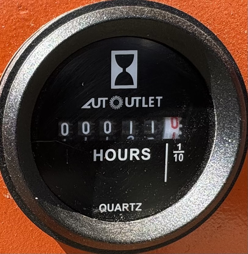

Overall moved another 5-7 ton of sand. Also hooked up the neighbors harrow and began to drag the beach. Stopped when it started missing again. Still was able to achieve quite a lot in a few hours. Will finish tomorrow AM.
Total time on our new little orange friend is 11 hours (8 hours spent on moving and grading the sand).
