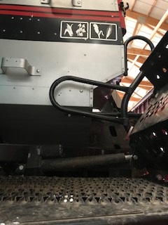

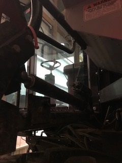

I will take a picture tonight of my R62 ladder. It has the power fold

My R62 has 2 switches also. There is 1 in the cab and another by the base of the unloading auger.
