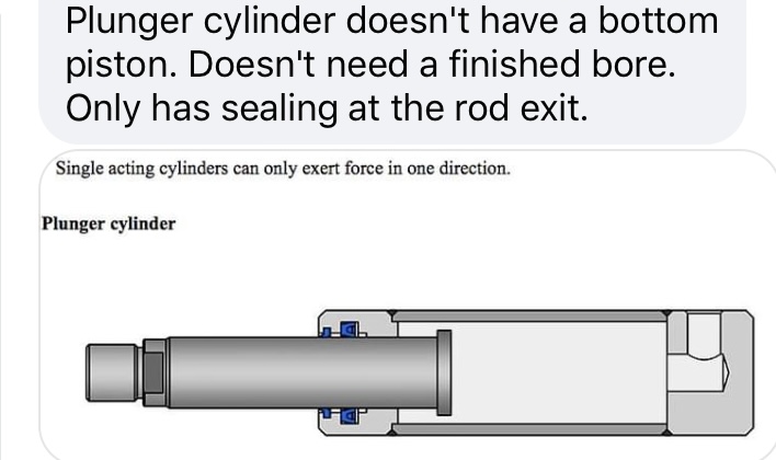

not a lot to the cylinders, no machined bore except for the top tube section where the nut tightens against the ā€œVā€ packing and the two bushings the rod rides on are. The rest is just pipe or rough cast. There is no piston or a bore for it to ride on.
