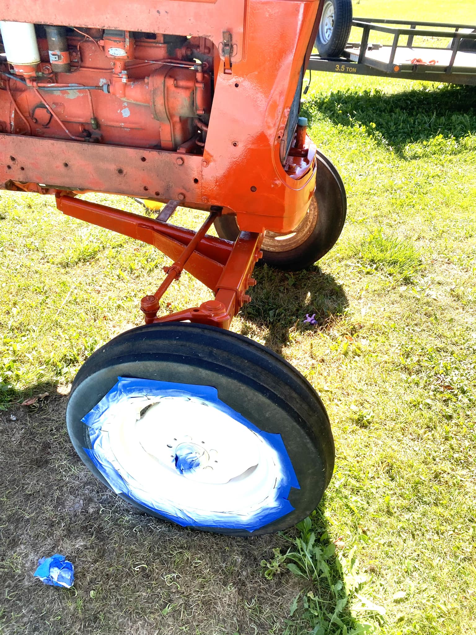

Getting to the fun part!
Series III is getting a new shine.
I do understand this isn't a proper restoration, but for my intentions I'm happy to see it running and looking better.

That tractor has had a Gleaner model "E" engine installed into it.

Hee hee... I see what Doc saw!  ;-)  Anybody else notice it??
