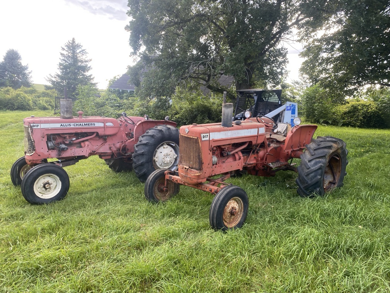

I recently extracted my childhood tractors from a barn they have sat in for the past 10 years.
As you know, they're D17 Series III and Series IV.
They ran and functioned perfectly when parked in 2014.
I'd like to get them restored myself.
I am hoping you all wonderful people can give me some guidance.
I want them to be mechanically sound, then cosmetically nice.
They are not running and I haven't even started anything.
First, where should I start?
Does anybody have a checklist or any specific guidance for me?
I'd be happy to pay.
I just want these done right, no matter how long it takes.
I'm looking for:
1) Drain the fuel by unhooking this hose, then do this
2) Clear out the ______ by ______
3) Check the ________ by pressing the ________
4) Buy a _________ from ________
etc.
They don't need to win any shows, but they should be mechanically sound and cosmetically nice.
Thanks in advance!

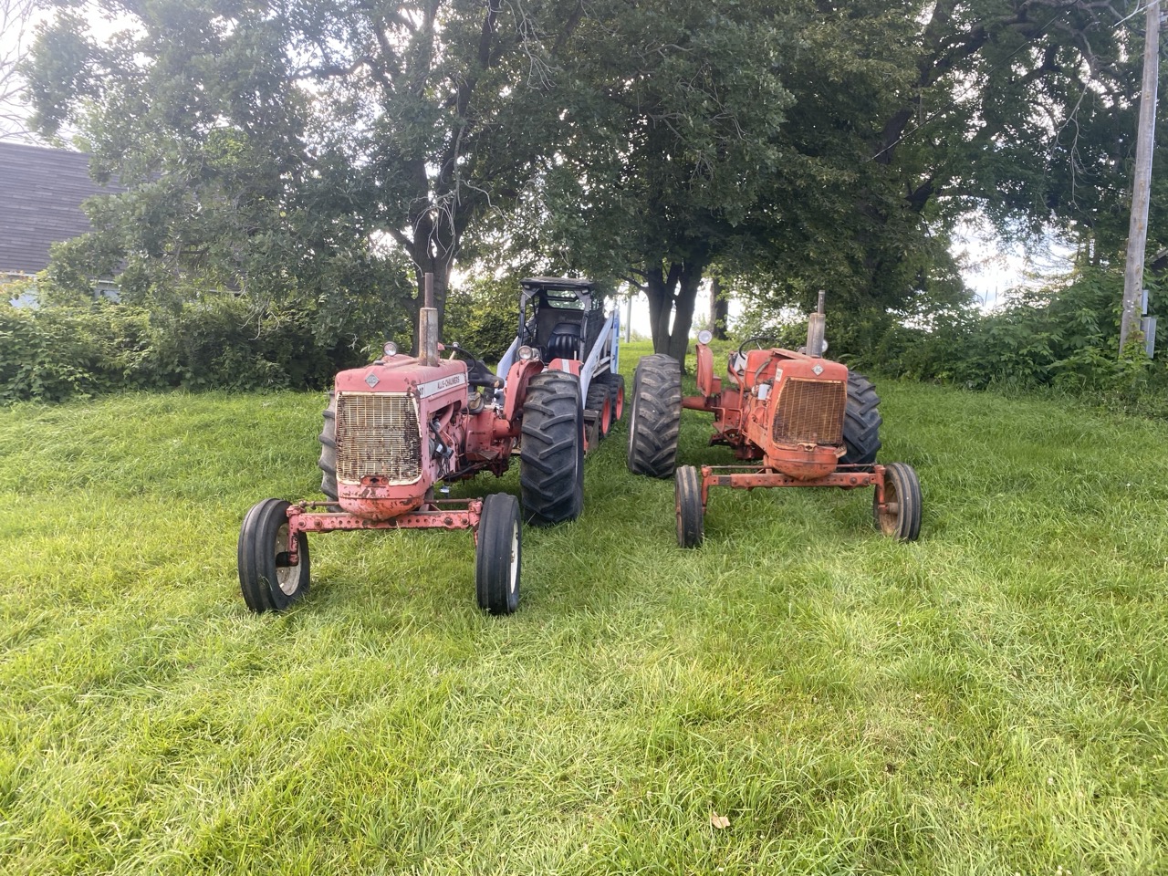

UPDATE: I have tried firing both of the D17s...
All of the fluids looked great. Oil was perfect. The Series III needed coolant topped off. Fuel tanks were both totally empty.
I cleaned the fuel sediment filters.
Changed out new spark plugs.
Both tractors are turning over but not sparking or firing.
Next step look into the carbs?
Thank you for your help, everybody. It means a lot.

UPDATE: Not much progress.
Focusing on Series IV.
Turns over but no spark.
Replaced spark plugs.
Filed points inside distributor.
Replaced solenoid.
Turning over but no spark and not firing.
Where do I look next?

Series III:
I had tried turning it over and it was barely turning, I didn't want to push it.
Mechanic found that one of the battery cables was bad, so he replaced it and it fired right up. Has been running great ever since.
Series IV:
First, the points needed to be shaved and reset to get spark.
Then, the fuel lines to the carb were clogged and needed to be blown out.
Lastly, the carburetor itself is gummed up and needs a rebuild (ordered the kit, he'll be back to do the rebuild).
He got it running by bypassing the carburetor to narrow down that as the problem.
Overall, it was all the things you all mentioned it would be but I just needed someone with the experience to troubleshoot it.
I'm thrilled with all the help I've gotten on here and that they will have new life!!

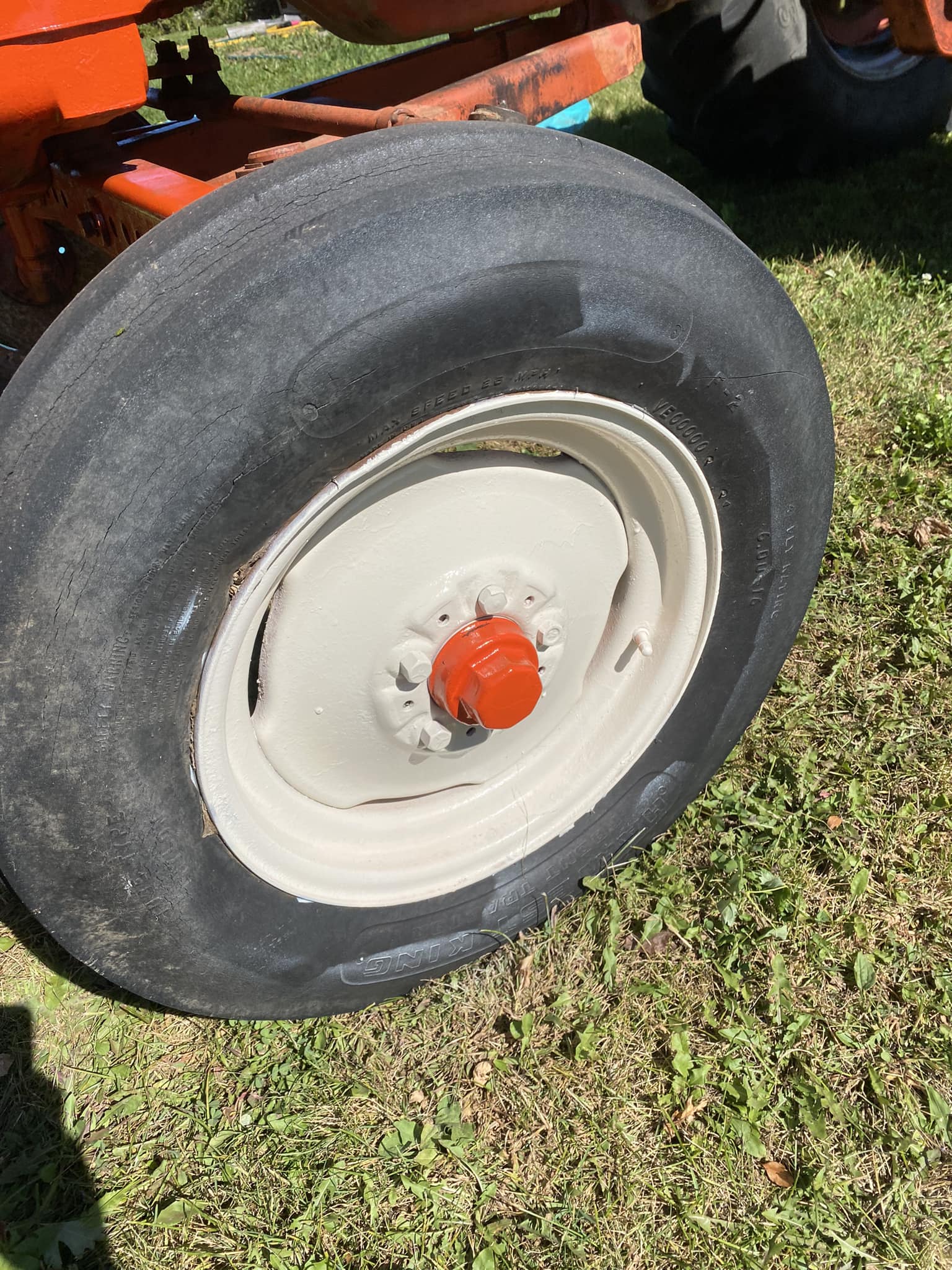

Getting to the fun part!
Series III is getting a new shine.
I do understand this isn't a proper restoration, but for my intentions I'm happy to see it running and looking better.
Posted By: DrAllis
Date Posted: 22 Sep 2024 at 4:39pm
That tractor has had a Gleaner model "E" engine installed into it.
