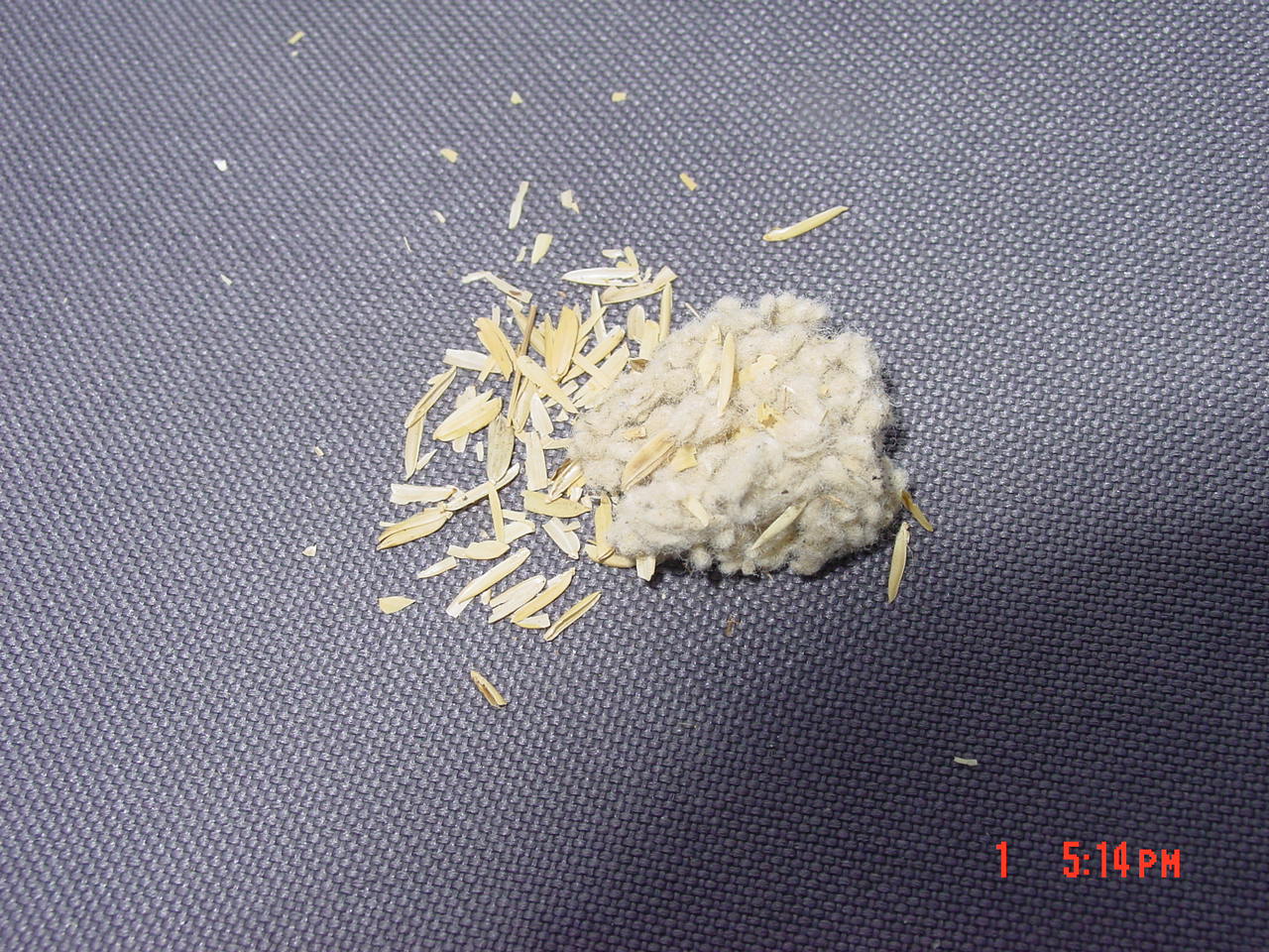

Originally posted by HoughMade HoughMade wrote:
Originally posted by Ray54 Ray54 wrote:
Wink Just saying, you don't have to look real hard to find people saying Fram is the same as not having a filter...
And these people may know something about '09 Corollas or 2012 F-150s, but they probably know nothing about the bypass oil system on a '48 Allis B or '57 WD45
Perzactly! The bypass system uses the restriction of the wad of cotton in the filter for pressure and can NOT be compared to pleated paper filters of any manufacturer.
their's a little more than cotton in there...

Post Options Post Options   Thanks (0) Thanks(0)   Quote Steve in NJ Quote  Post ReplyReply Direct Link To This Post Posted: 01 Jul 2019 at 8:00am
But who makes the filter for AGCO? Not AGCO that's fir' sure! More than likely, one of the large filter companies...... Fish are you sure that's not a mouse nest??  LMAO!!
