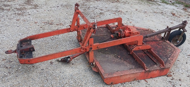

Hi Guys I was lucky and brought home an Allis Chalmers snap couple 160 rotary mower. I've seen some pull types but not to many snap couplers.
It seems to be in pretty solid shape and not rusted out. Blades are good but need sharpened.
Previous owner took off the front skids but they came with it.
It has a homemade tailwheel on it, but it should work ok.
The slip clutch has been welded together so that will need some attention.

Early Danuser made unit, nice find!

That lookes like a rare find indeed.
I have a drawbar pull type mower with the two side wheels.
Works well on the WD for chopping corn rubble after ear picking.
Had to use it a bit on the shaggy lawn after the zero turn decided it would only drive in circles... Another repair to do.
Was the wheel put on your mower find to run with a bad hydraulic lift? Or just ensure consistent height cutting?

So did these snap coupler mowers not have any tailwheel from the factory? This tailwheel was in it when I got the mower. This is the only one I"ve ever seen that wasn't pull type
Looking at the way the hitch is solid you might not need one.

Mine has a factory tail wheel.  Below is a picture of mine with the tail wheel.  The manual shows them both with and without a tail wheel.  Mine has a sheer bolt rather than a slip clutch, but the manual shows the slip clutch as an option.  Wish mine was six foot rather than five (don't know if they made them six foot) and that it had a slip clutch.  It is not difficult to mount.

Thanks for the pictures Dave. That's a nice mower with a facotry tailwheel!
Your's is the first one I've seen other than the one I just bought. I have a snap coupler Wood's mower too, but I never got it running.
Sounds like maybe mine came wihtout a wheel and someone wanted on. seems like it would be nicer wiht a tailwheel.
3-point mowers tend to just dig in if they ride on the ground.
I looked and there are several options to buy new aftermarket slip clutches for under $100.
It will probably go on my D17 becsaue I'm nervous to hit somehting and tear the PTO gears out of my WD45. I wish it was a 6' also to at least cover the tracks

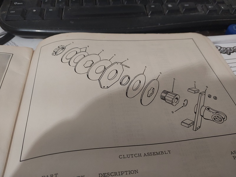

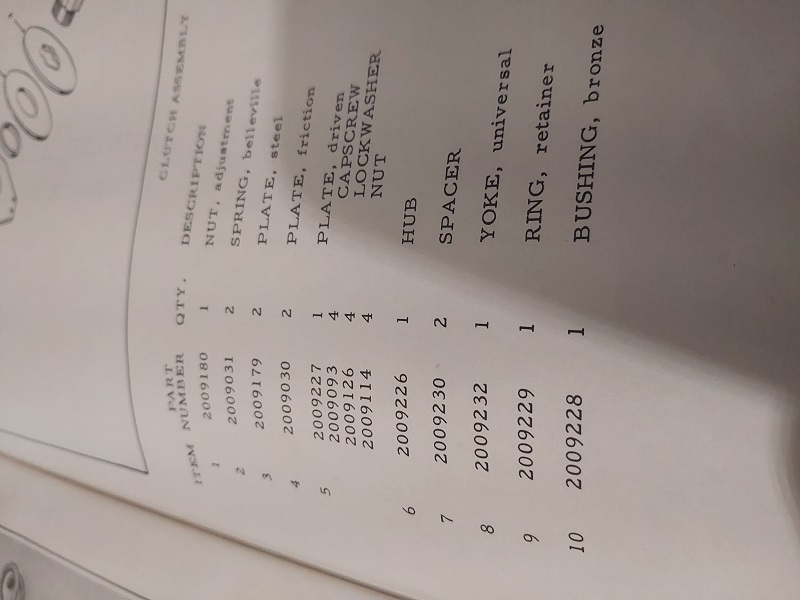

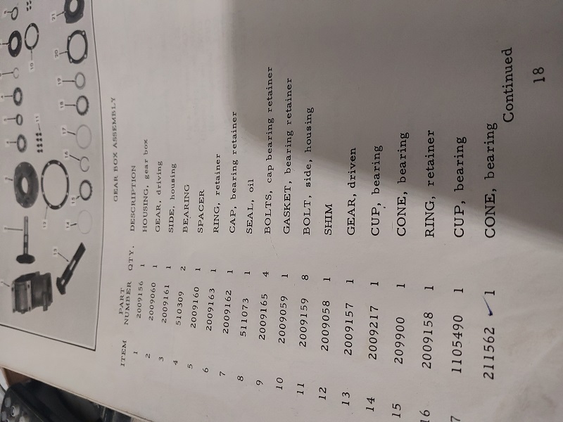

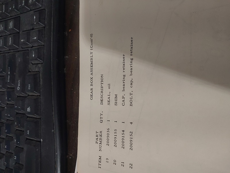

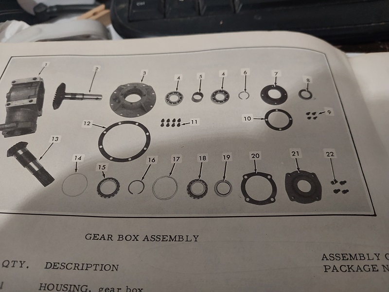

Dave here's some pictures out of my 160 parts books you'll have to a a 70 to the front of the parts number.

Thank You!!! That's very helpful. Now I can call and see what's available before I tear it apart. I"m guessing the bearings and seals are just a standard size that could be matched up.

Kenny not 70 on all those numbers. Just 7 to the seven digit numbers. You want to end up with eight digits for agco numbering.
Which parts are you looking for. I’ll check our stuff

Do you have part numbers

This all I can find in the book I've.

Well, my owner's manual does not show a part number for the slip clutch.  It simply says the mower can be purchased with a slip clutch as a factory installation and has a picture.

Dave show me what you have. I’ll see what I can find. The picture that Kenny put up looks like Dave’s first picture

Here is a picture of the slip clutch from the manual.

Oh, I see there is a number at the top of the page I didn't see before; 532768.

The only parts we have left is #4 and #8 in Kenny picture
