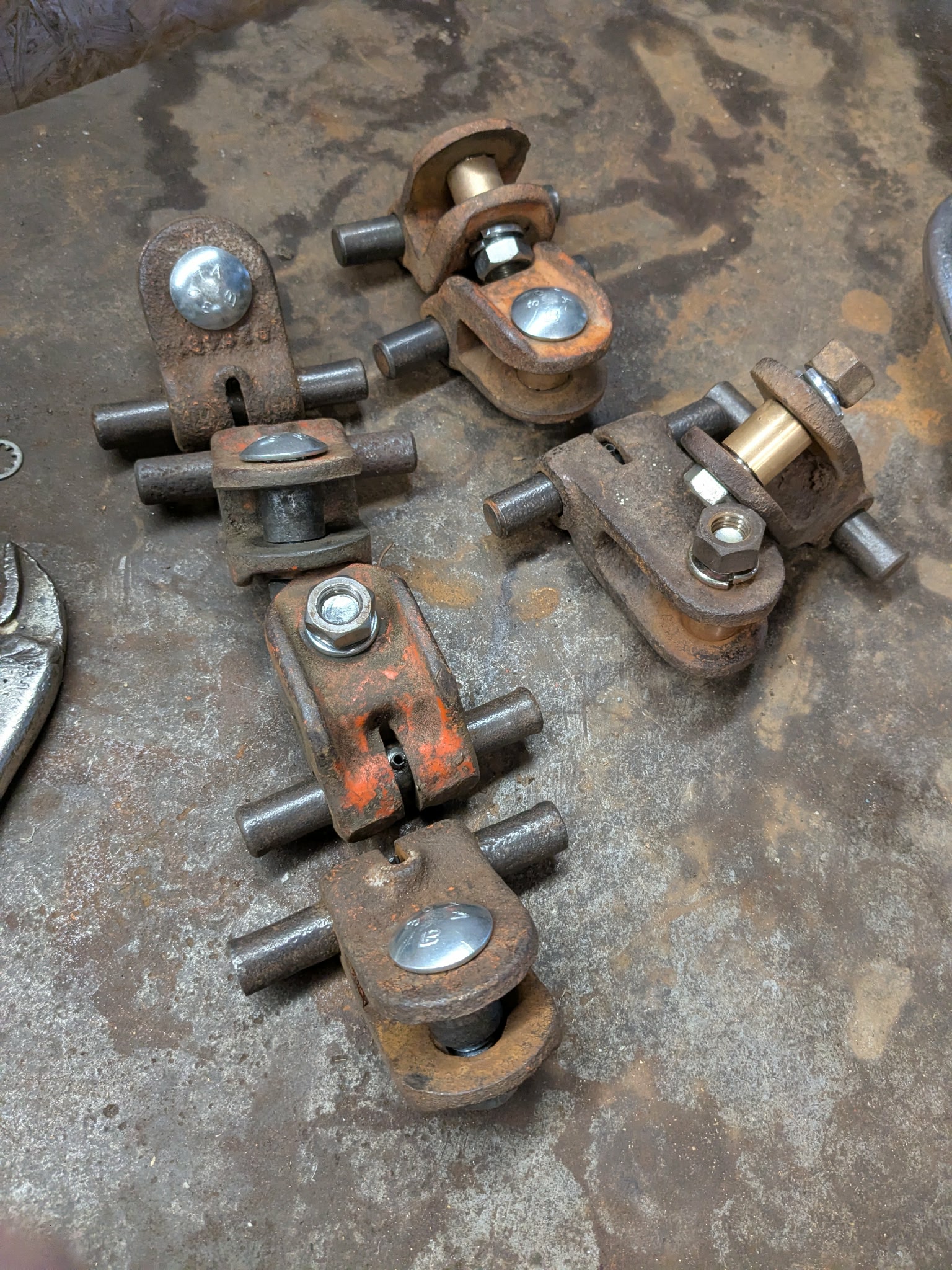

All new nuts and bolts here Steve!  All good now - thanks for caring!

Lookin' good Myron!!  Thumbs Up

are those brown bushings steel?

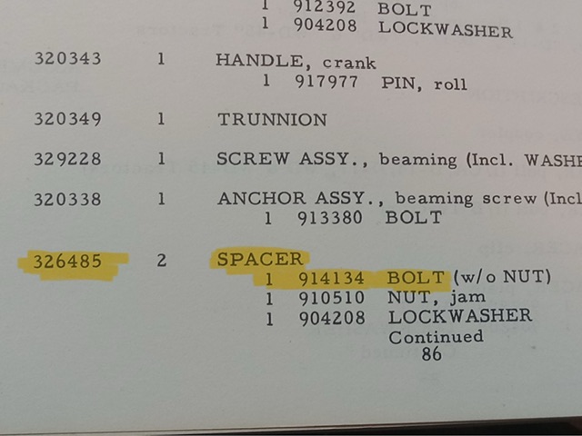

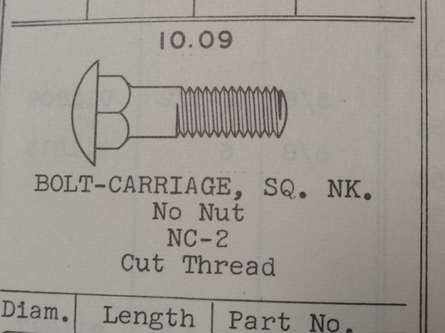

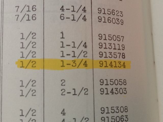

First picture is from plow book for spacer and bolt. Second, third picture is from standard hardware book.
Yes, got them from my local industrial supplier.  Just had to cut them a bit shorter.
