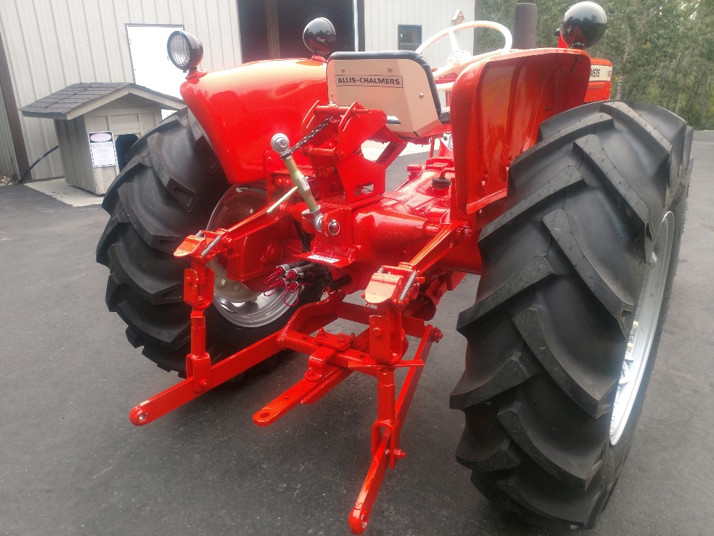

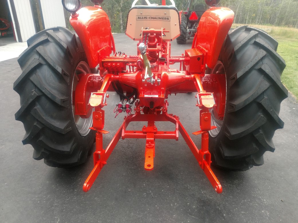

ou mentioned putting a 3 point on your D15, which I have done to mine. I bought the adapter from Tonys Tractors. Had to drill 1 hole in drawbar to mount the adapter but otherwise was very easy to do.  Top link bracket mounts under seat, and the Cross style lower links are mounted to the drawbar.  Works quite well.  Only limitation is there is no position control with the modified snap coupler.

Thanks, Modirt. Especially for the pictures.
