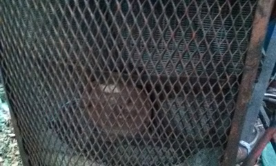

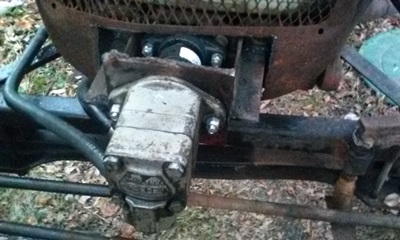

Hi guys I just finished doing some upgrades on my 48 c and I'm feeling a little Guilty for altering such a great tractor any of you feel this way?
If it was a show tractor I would keep it like it was made but I need to use it so I had to do some upgrades.
I just added an electric fan to replace the louvers and took off the engine fan.
And added a crank mounted pump.
When I finally get my skid loader the tractors will be restored but it may be a few years .

I understand the need to use it, but why did you add the electric fan when the mechanical fan worked fine all these years?

I replaced the fan for cold weather operation to get faster warm up.

temp controlled electric fan makes sense to me

thermostat is suppose to control water temp, and the lovers were used before the tractors came out with the thermostats on them...Now if you don't have a thermostat on the engine already, ...  I would hut for the housing and put one on.  like the others said, it's your tractor, and you did whatyou needed to do... live hydraulic will be nice when using a loader.... just that now when starting i cold, you will be turning the pump too... Should have put on an electrical engagement for when you were going to use it... Ermm  LOL

I hope you still have the pump on it to circulate the water?

That looks like a vein pump to me. If it is they really don't have any rotating resistance until they turn 500-600 rpms. Ideal for cold morning starts. I have one on my WD. Nice job on the tractor!
