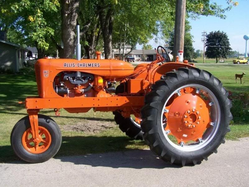

I really can't help on most of the questions, but this is DaveinGB's 45 highcrop which I'm pretty sure has 38's on it...hopefully He'll see this post and chime in with some details.

Thanks for posting  a picture of my 55 sfw Hi-Crop Chad.  Near as I can tell, this tractor was used to pull a sprayer in the vegetable fields in calif.  It had allis 38" power shift wheels  from a D-series.  It was missing the hydraulics and in place of the snap coupler hitch, it had a HD homemade hitch.  The single front  wheel with the tall fork is original to the tractor.  I put the 8 to 9bolt rear wheel adapters and wheels and rims on it as shown in the parts book.  It rolls down the road at a pretty good clip!
