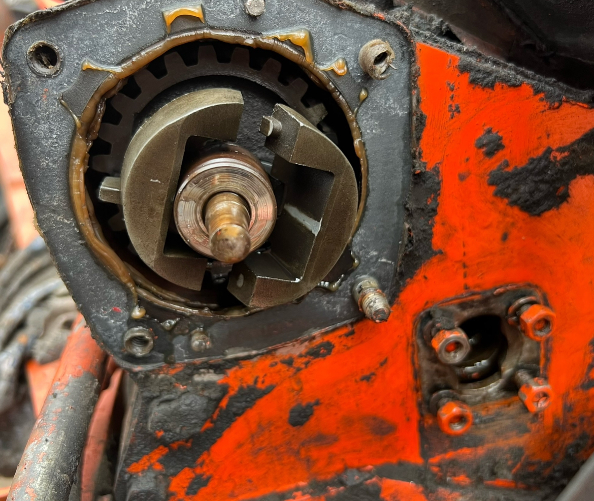

Chugach View Drop Down
Joined: 30 Nov 2023
Location: Alaska
Points: 36
Post Options Post Options   Thanks (0) Thanks(0)   Quote Chugach Quote  Post ReplyReply Direct Link To This Post Posted: 18 May 2024 at 10:27pm
Bearing seems a little wonky
55allis View Drop Down
Joined: 30 Jun 2020
Location: Griswold Iowa
Points: 1275
Post Options Post Options   Thanks (0) Thanks(0)   Quote 55allis Quote  Post ReplyReply Direct Link To This Post Posted: 19 May 2024 at 12:15am
Is this just my eyes or is something missing?

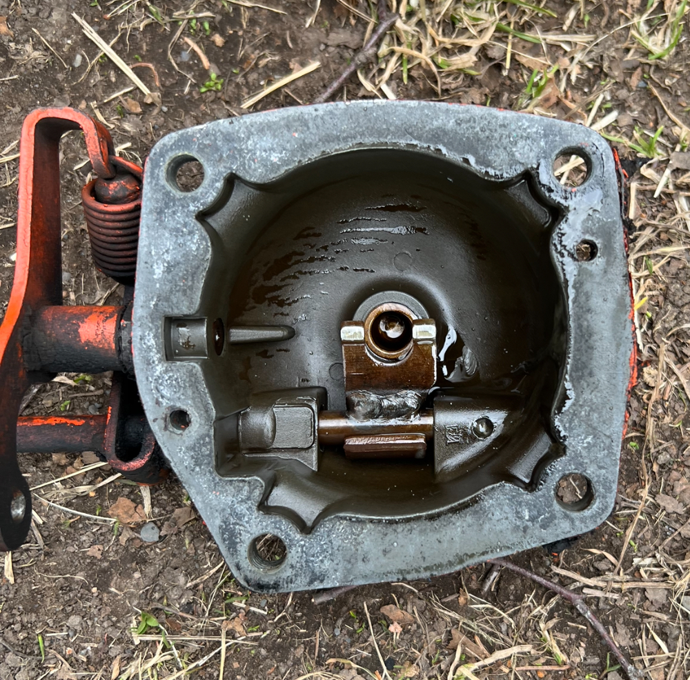

Joined: 30 Nov 2023
Location: Alaska
Points: 36
Post Options Post Options   Thanks (0) Thanks(0)   Quote Chugach Quote  Post ReplyReply Direct Link To This Post Posted: 19 May 2024 at 2:16am
Here is the cover
Points: 22581
Post Options Post Options   Thanks (0) Thanks(0)   Quote DrAllis Quote  Post ReplyReply Direct Link To This Post Posted: 19 May 2024 at 7:03am
Nothing there that has "locked" up the engine. Is there a loader on this tractor with a front hydraulic pump??? Do the fan blades turn when you push/pull on them ??
Points: 8867
Post Options Post Options   Thanks (0) Thanks(0)   Quote Mikez Quote  Post ReplyReply Direct Link To This Post Posted: 19 May 2024 at 7:39am
Did something find its way into a gear. Cam,crank,governor
