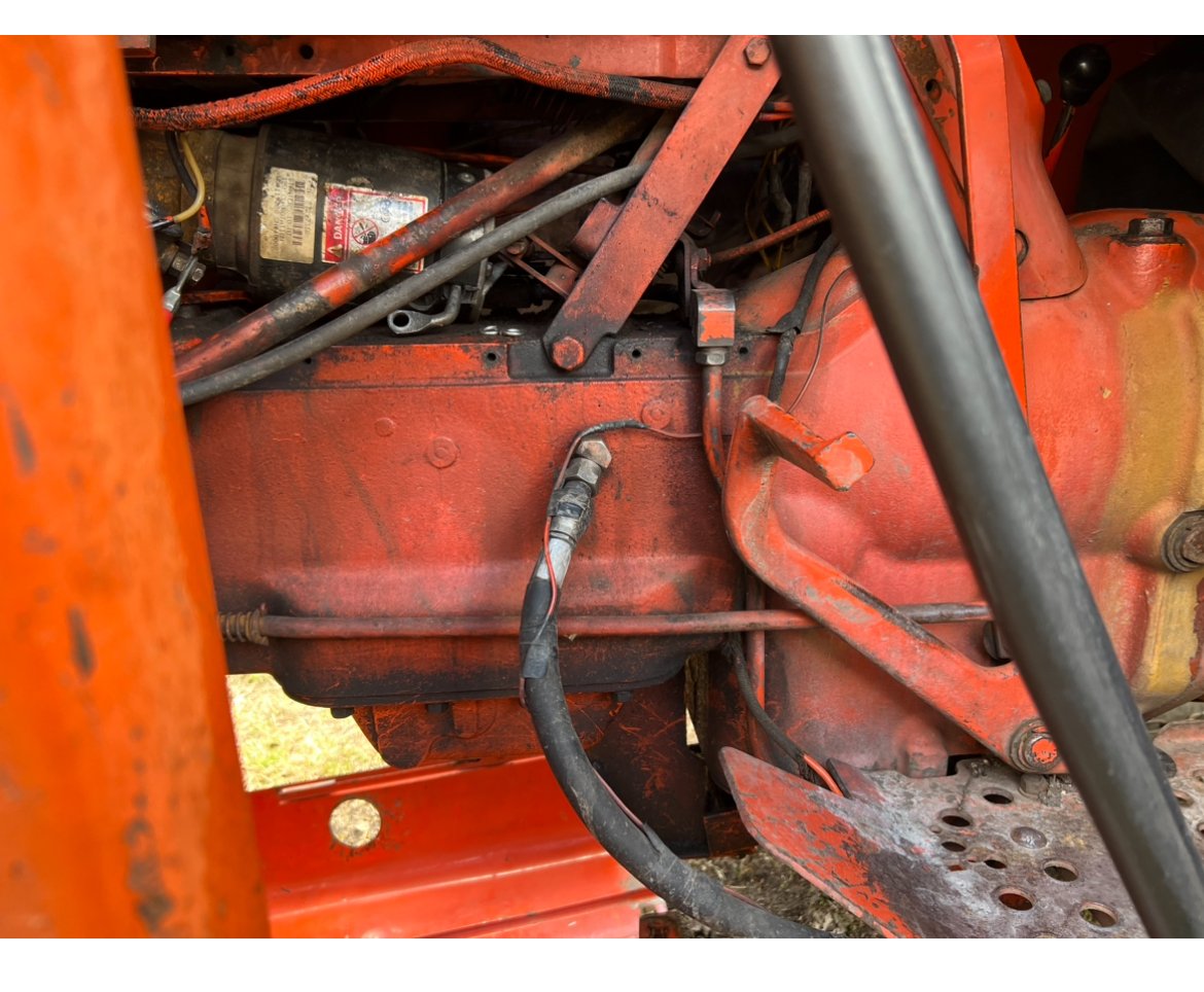

Posted By: Chugach
Date Posted: 18 May 2024 at 10:26pm
Posted By: Chugach
Date Posted: 18 May 2024 at 10:27pm
Bearing seems a little wonky

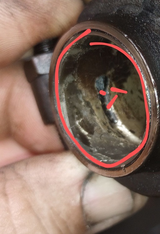

Posted By: 55allis
Date Posted: 19 May 2024 at 12:15am
Is this just my eyes or is something missing?
In the red circle?

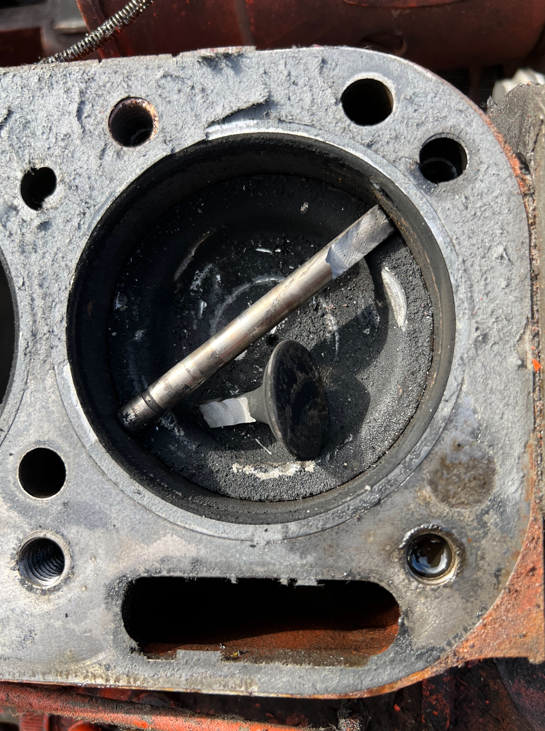

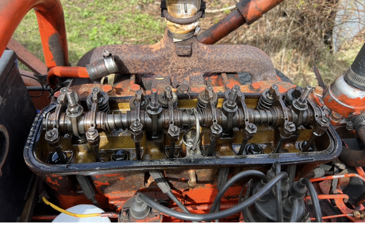

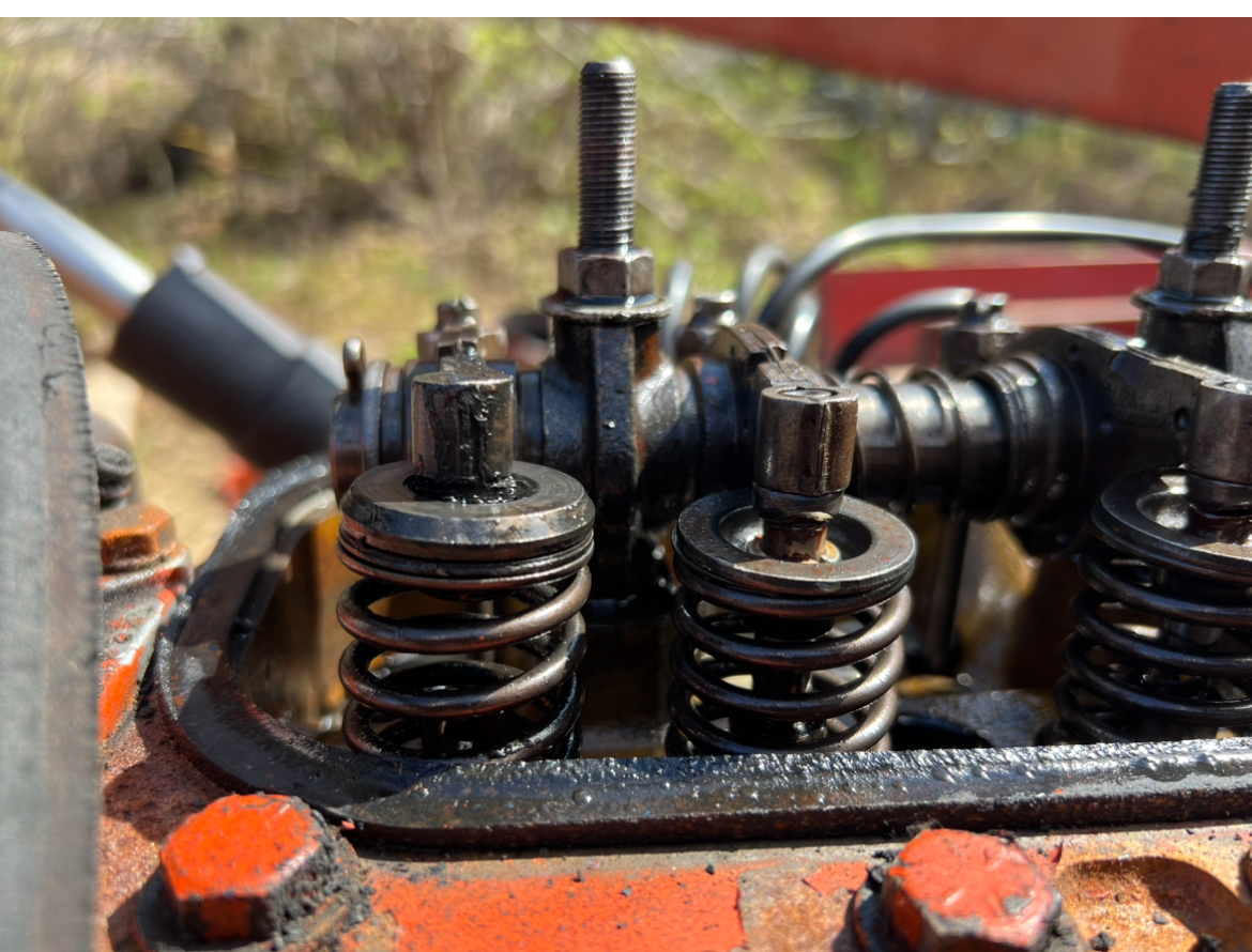

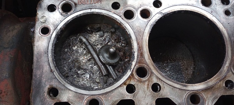

I need to get my eyes checked. Seems like something is missing.
Again thank you all very much for your help.
Chugach
Posted By: DrAllis
Date Posted: 20 May 2024 at 6:45pm

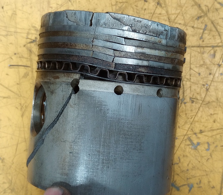

BINGO !! dropped the number 1 exhaust valve. Will need at least one piston and head repairs.

how may hours on the engine ? .... Head will be off... is it worth doing a valve job and    pulling all the pistons / new rings ??
Posted By: DrAllis
Date Posted: 20 May 2024 at 8:38pm
There was a time 40 yrs ago when you could have bought one piston and maybe one sleeve. In recent years buying a "motor kit" was impossible as no one even made them for a G-160 engine. Don't know if that is still true or not.
Posted By: steve(ill)
Date Posted: 20 May 2024 at 9:47pm
You can buy a "KIT" for a complete overhall... Dont know if you can get one piston or not.. or if it would match the original ???..... Unless you get a used on on e-bay.

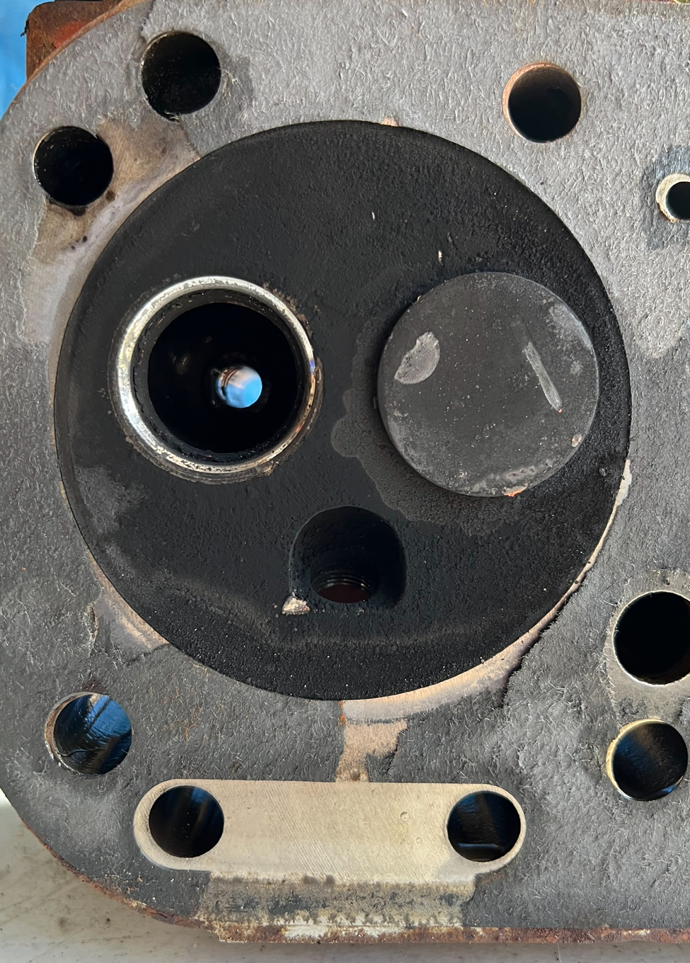

Date Posted: 20 May 2024 at 10:00pm
Posted By: Chugach
Date Posted: 21 May 2024 at 3:11pm
Thanks for the piston sites. I blew a head gasket last year, and had the head resurfaced and new valves. I did not replace the pistons. I am just glad I didn’t rip into the timing gear cover.

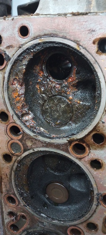

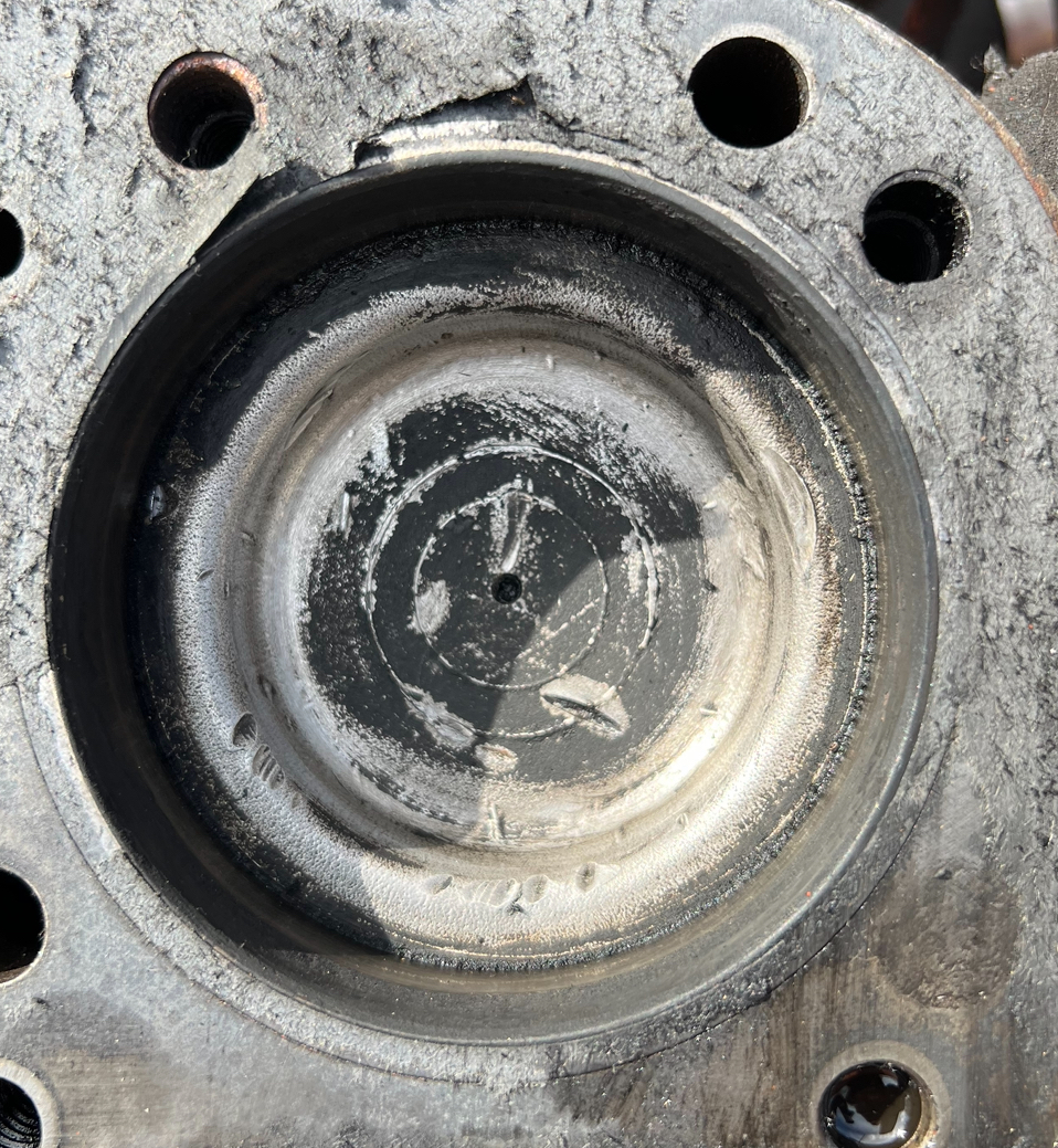

Posted By: Fred in Pa
Date Posted: 21 May 2024 at 7:43pm
This was one of my customers last fall . MF 65 176 Cont. Gas .
He was bush hogging when valve dropped  .
Don't forget to pull rocker arm assembly apart.
nonetheless ,still dead.
Posted By: Chugach
Date Posted: 21 May 2024 at 7:55pm
Wow! That’s what I have to look forward to. Thanks for the advice and pictures! 40 degrees and rain today, not conducive for playing with tractor. I will attach pictures of my dilemma. I have high hopes that all I have to do is replace the valve … just kidding!

Originally posted by Chugach Chugach wrote:
...  I am just glad I didn’t rip into the timing gear cover.
Yup, that would have been a waste. Obviously that piston did not move all the way upward when you disconnected the rod cap Ouch

When can dropping a valve still be lucky.
Date Posted: 23 May 2024 at 8:46pm
if the top of the piston looks as good as the valve seat.... you might be in Business !
Posted By: Chugach
Date Posted: 23 May 2024 at 9:01pm
It has a few battle scars.
Posted By: Les Kerf
Date Posted: 23 May 2024 at 9:06pm
Reckon the keeper didn't keep'er so very well Cry
Posted By: Chugach
Date Posted: 23 May 2024 at 9:51pm
Many years of faithful Service. I am glad I had the key in hand when the noise started.
Date Posted: 24 May 2024 at 7:13am
Check the rocker arm play on shaft
Posted By: Chugach
Date Posted: 24 May 2024 at 12:34pm
Will do, thanks
