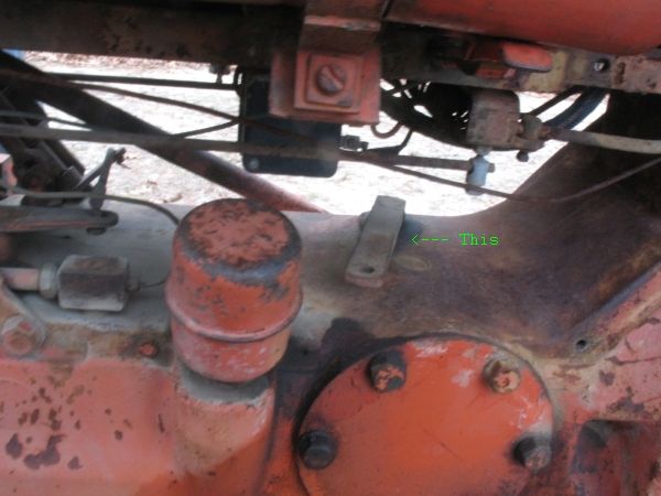

Well, you sorta need the rod for the knob to attach to if it is also missing.  The rod attaches to a flat leaver under the gas tank.
Points: 18943
Post Options Post Options   Thanks (0) Thanks(0)   Quote Ted J Quote  Post ReplyReply Direct Link To This Post Posted: 24 Feb 2015 at 8:44am
The rod attaches to this;
Hope this helps...
PS Guys, is this in the 'ON' position?  Even though there isn't one.  Will this hurt the gears or anything?  TAT

TJ - I'd guess that it'd be on in that position as my rod was pushed in and the arbor spun freely on mine. I don't think that it'd be hurt if it was on and the oil levels are full. HTH.
