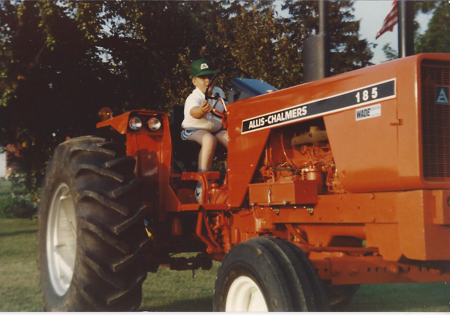

I can't help much either with the changes, this was mine, recently sold, built at the end of 1980, Hydraulic PTO, 1000/540, single headlights, two remotes, 1700 hours when I bought it, all original including Dealer stickers and instructions on the block about changing break-in oil. Beautiful tractors to own and operate. Anything below 40 degrees and it really liked being plugged in for about 30 minutes, then she would crank right up, even at 15 below, I don't believe she ever saw ether from what the previous owner told me, and I never gave her any.
