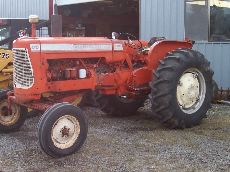

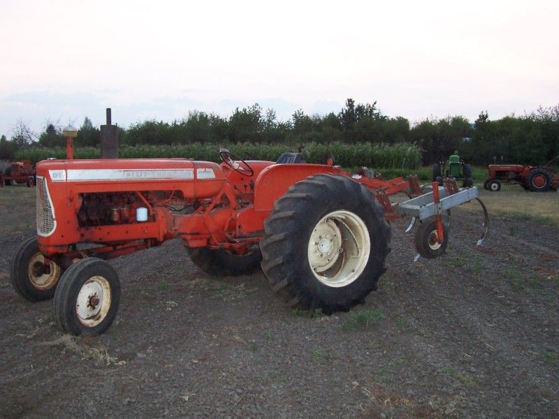

Here is the same tractor with short front spindles, 6.50-16 on front and 16.9 x 28 Firestones on the back....I think Firestone makes the best looking and riding tire out there!

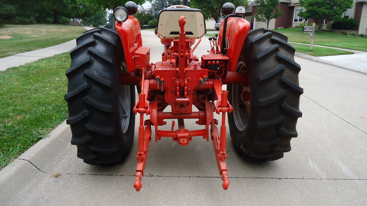

Gatz, if that's the old gal you did up a few years back, I kept every pic you posted as I had not picked up a D17IV as yet and she gave me something to shoot for. Nice, very nice.
