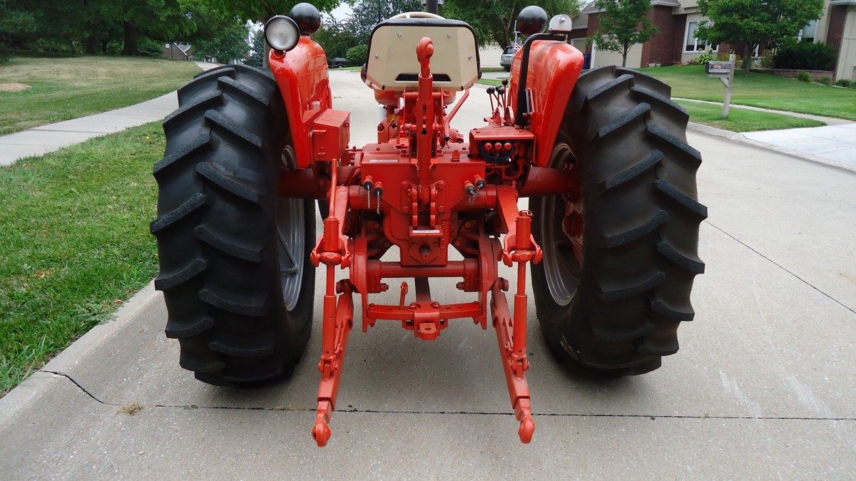

Need to get started on an ol' D17DIV I picked up a few years ago. Came with newer MF or Case-IH rear two position rims and junk tires that barely hold air. Found period correct OEM rims/centers that I am having blasted before painting and would like to know what size folks are running for rear rubber. Have seen some pics from shows where some used some "fatties" front and rear and although it looked tough, this will be a working tractor to earn her keep. Data I have shows 14.9-28's for s/n 42001 and up which is 1962 onwards. All for the tallest I can get on these original rims. Comments/pictures welcome.

I would go with 16.9x28 if it were mine. Im pretty sure 18.4x28 would fit as well but much harder to find used & much more expensive new.

I've got the 16.9x28 on my series IV's. Have the 18.4x28 on my one-eighty. Wouldn't want to go any smaller than the 16.9's. Dave

My 1960 D17 has 16.9X28 tires and I wouldn't want to put smaller ones on it. The 17s look under-tired to me with the 14.9x28 tires. My father bought a new Series 4 D17 that had 18.4X28 tires. Sure made it look like a beast. Your choice will likely depend on your rim width.

Per Agco partsbook it's a 13X28 rim on a D17 enough snow thawed I could get the shed door open at my grandparents and his 17 has the same 4 rail 13X28 rim with a 16.9X28 my 160 does. His 17 has had 16.9X28 for for atleast 40 years and it has been fine.

16.9 x 28 ... don't go smaller.
