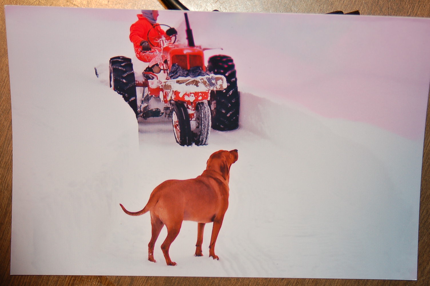

Sorry for the scale on the pictures, as I just cant figure out how to post them correctly yet.

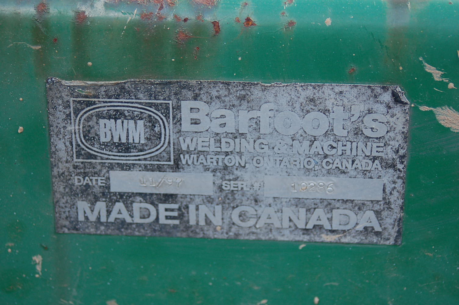

Anyway, the 2 pictures are of my WD blowing DEEP snow after a blizzard. 6' wide single stage(old) Badger snow blower. I worked great in deep snow. I used it for more than 15 years. Bought it used way back then. This fall I traded it in for  Barfoot 6', 2 stage blower. Barfoot is basically a Lucknow. Bought it used. I think the 2 stage will work much better in less snow. 4" to 8" and wet stuff. I wouldnt even use the single stage in it because it would plug up. The picture showing the blower is on my D-17. I replaced the WD a couple years ago with that. I will get pictures of the Barfoot working when we get some snow.
