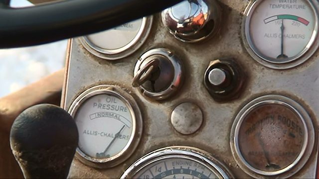

Oil pressure on a D17 with the full flow oil system should always look about like this!

Post Options Post Options   Thanks (0) Thanks(0)   Quote cnafarms Quote  Post ReplyReply Direct Link To This Post Posted: 12 Mar 2015 at 2:16pm
That's how my gauge looks so that's a relief to me. Not sure what the fram number was but went to the agco dealer told them what I had they gave me the oil filter I needed. I'm guessing from the serial number which is D17 66267 makes it a 1963 not sure when the break was from series 2 to series 3 occurred. Also an older gentleman that still farms with Allis told me it was a series 3. And the part number you posted about the agco oil filter is the number that's on the filter ive got. Thanks to all who have replied. The info you've given is greatly appreciated

I own D-17 s/n-66260 (very close to yours) and yes it is a series 3 and mine has had high oil pressure since new. Gauge always looks like the picture that DanD posted. Mechanic at AC dealer back in the 70's once told me that if you are buying a new tractor and the dealer had several tractors of the model that you want to start all of them and buy the one with the most oil pressure.
