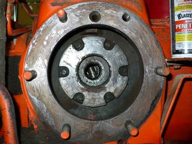

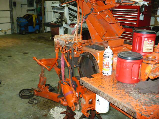

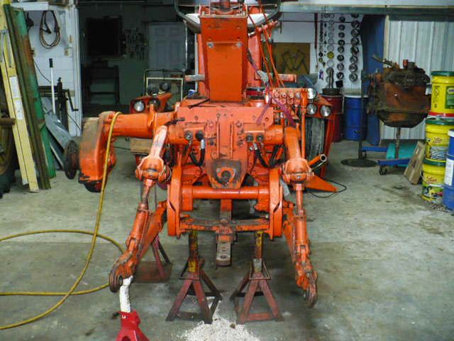

You will need to pull the axle off like Eldon said and it will look like, this tractor is a 185 but your D17 will be the same. this tractor was doing the same thing and I hope yours is not as bad as this one.

Don't let it scare you, just have some good heavy duty stands and a way to lift and hold the axle for removal, read the book two or three times before you start and it will save time. The left side will go faster than if you where doing the right side.  It's like most jobs, just getting started is the hardest part of doing something. One bolt at a-time.
The shots I posted above are of one of the worst you might run into.

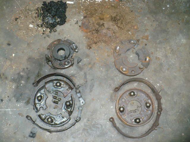

    Well got the final out and exposed all the carnage. I tried posting some pics. But says my file is to big. I did email Eldon all my pictures (thankfully he's been mentoring me) basically everything that holds the 4 balls together, is in about 20 different pieces all the way down to powder. The brake bands look to be intact and functional, not sure how think new ones are, but these are 1/8" thick. Shaft and splines look good on final. The rest of it is junk.

Thanx Don, yep I think mine is worse, at least there is more pieces. I see you had the bottom brake linkage out. Mine seems fines and even works fine. Can't I just take the pins out on both sides of the bans and leave the rest? Eldon says it's a bare to get the bottom pin out. It looks like I can just pull the pins on both sides
