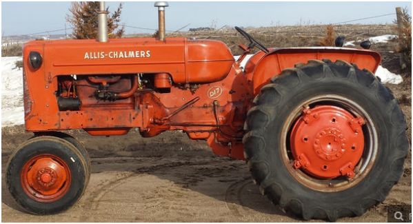

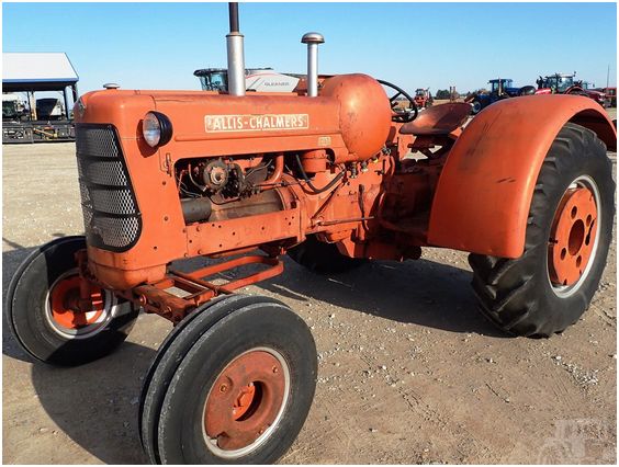

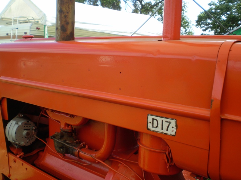

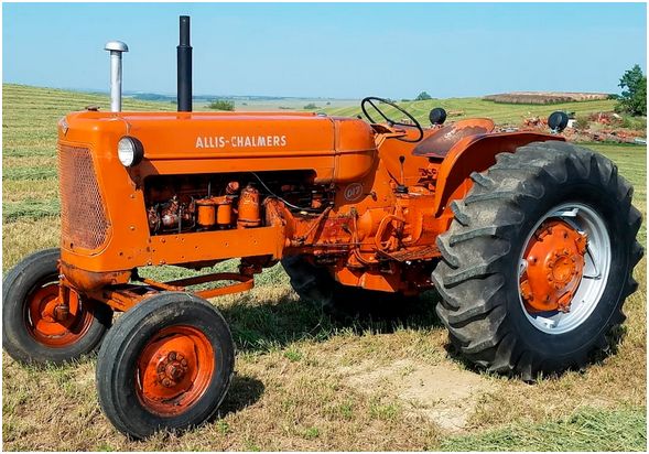

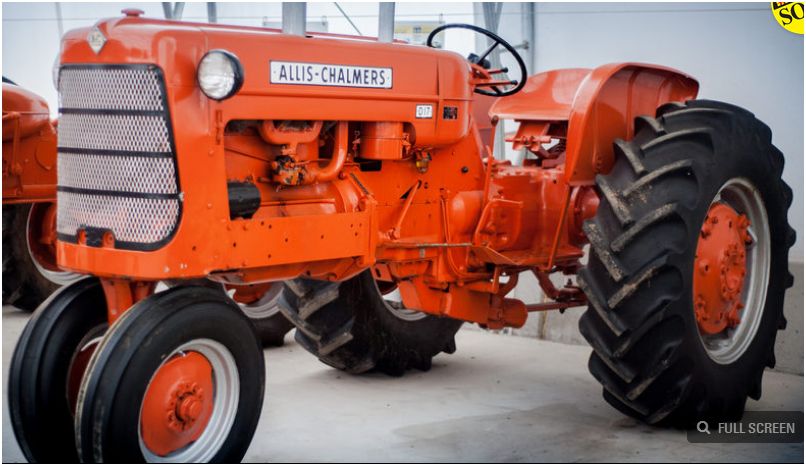

I spent a couple of hours this morning, searching through pictures that look farm fresh.
One of the pictures is a restored series I, that is clearly misrepresented as a '61, series II. I included it because the serial # is close to mine.
Edited by frnkeore - 24 May 2019 at 1:07am

1. '60 #28097 (LP Wheatland)
2. '59 #24948
3. '58 #13653
4. '58 #9371D
Edited by frnkeore - 24 May 2019 at 1:11am
