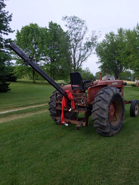

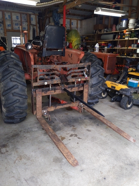

I feel like the pictures were owed to everybody who gave me insight on how to build this with ideas, I've been thinking and gathering parts for a long while to do this one!

Post Options Post Options   Thanks (0) Thanks(0)   Quote Hunt4Allis Quote  Post ReplyReply Direct Link To This Post Posted: 19 Jun 2021 at 4:29pm
I can use it as pictured or remove spear and use as a pallet lift, remove forks and add a ball in middle to go get firewood with my trailer in our back woods, also built a pig pole with lifting eye that's adjustable along the length of pole that I welded up from square stock and it attaches to top link

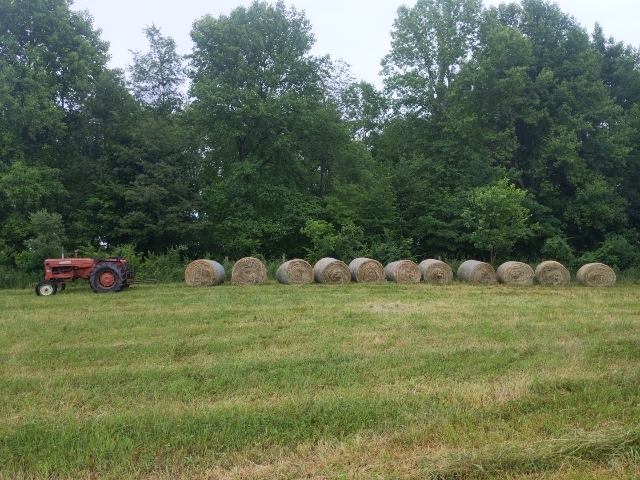

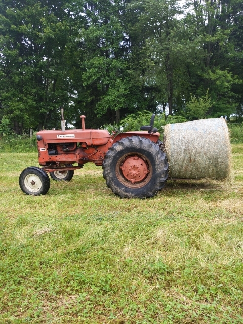

It worked perfectly!
Got them all moved in short time up on dry hill in pasture.
It couldn't have worked any better, not pretty but from a used pile of parts and some welding/ fabrication it all worked out nicely.
Thanks fellas

Post Options Post Options   Thanks (0) Thanks(0)   Quote BillinAlberta Quote  Post ReplyReply Direct Link To This Post Posted: 19 Jun 2021 at 8:00am
Yes it can .I can pick up 5x5 bales easily at 1200 lbs but it has a front end loader out front for weight.Usually carry 1 in front and 1 behind.
