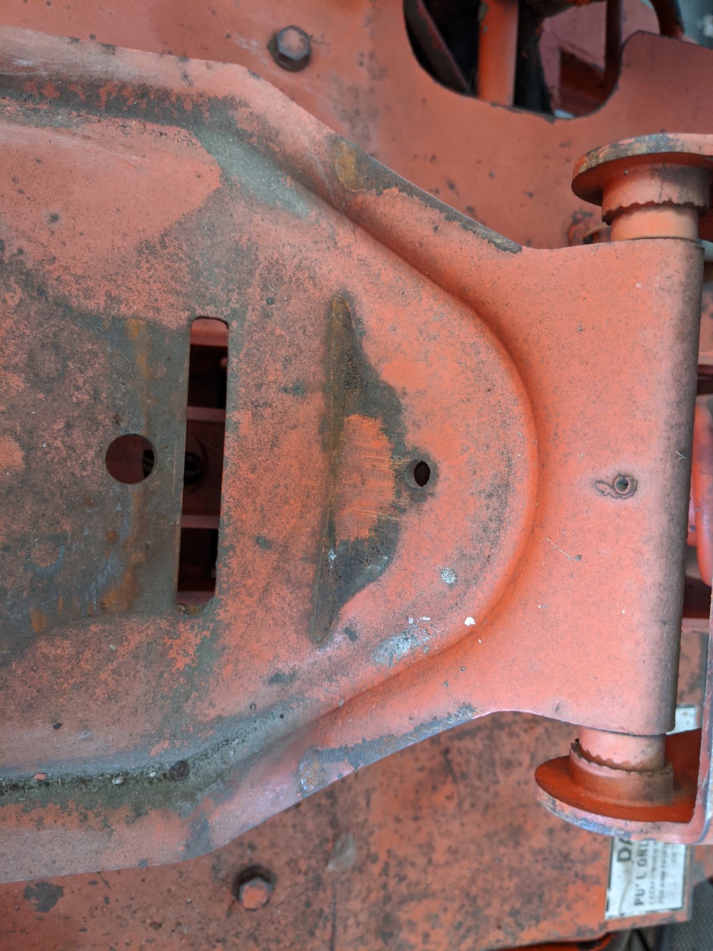

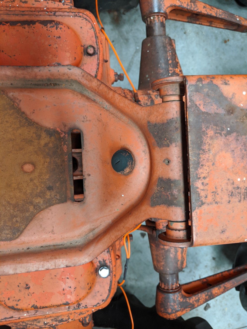

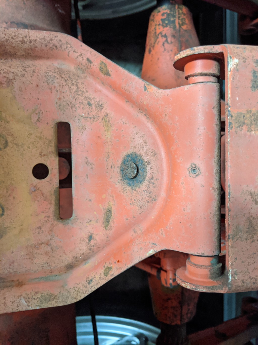

My 1958 D17 Diesel still has one this is what it looks like:
My series II D15 just has the remnants of one with the rubber missing the outline in the paint shows where it had been:
My Series IV D17 looks like it had something shaped quite different than the old "Button":
Edited by TomMN - 09 Jul 2020 at 11:08am
