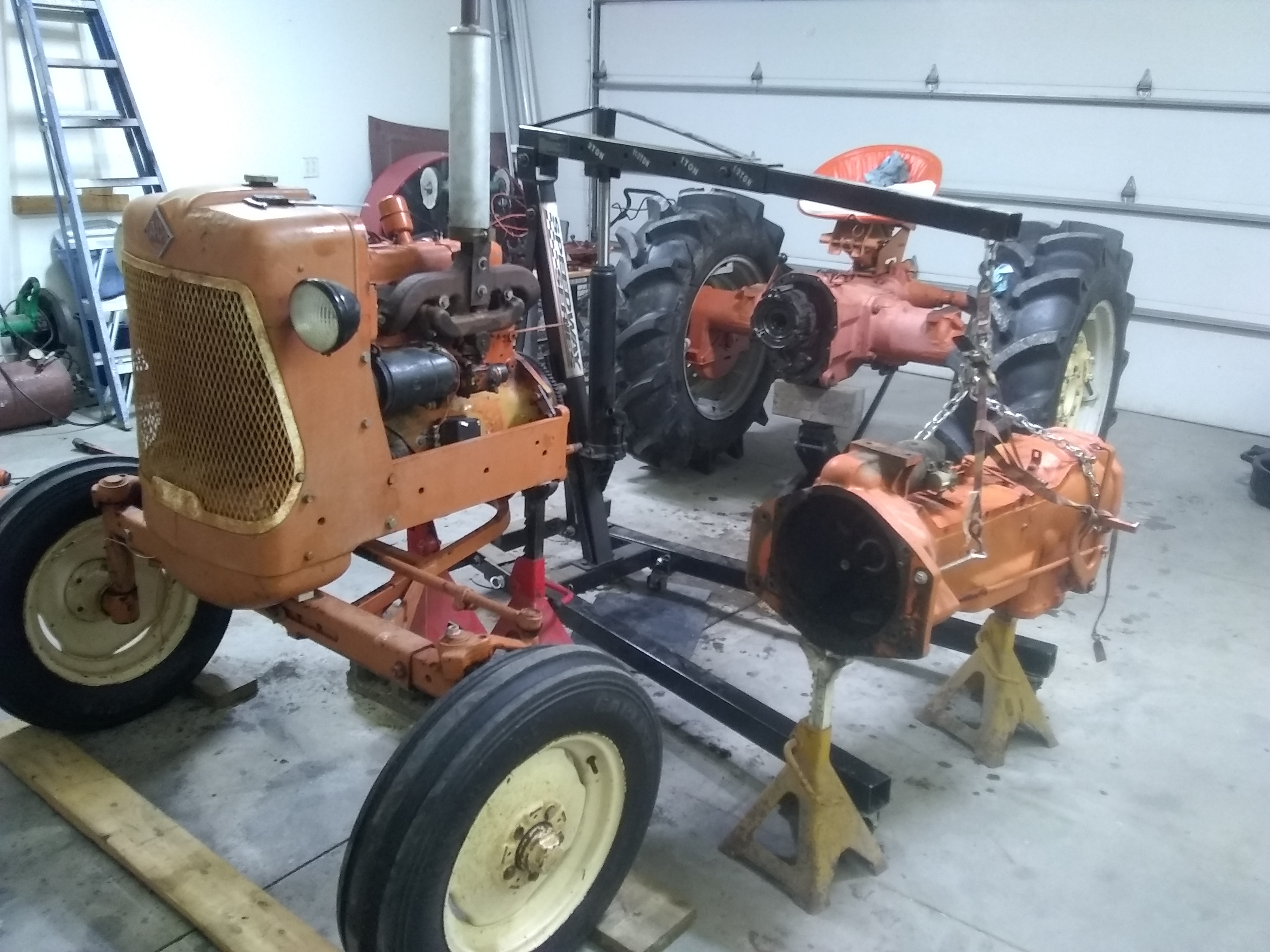

So I'm replacing bearings in the torque tube. I lost a bearing on the shaft above the PTO (intermediate shaft)? My question is there a kit that contains all the bearings and seals for this job?  I don't want to have to pull this apart again ever. So I figured I'd replace all the bearings. Or is it cheaper to take the time and shop for everything individually?
Any advice for reassembly welcomed. I just got the last of the shafts removed today and plan on getting it all washed out before putting it back together.

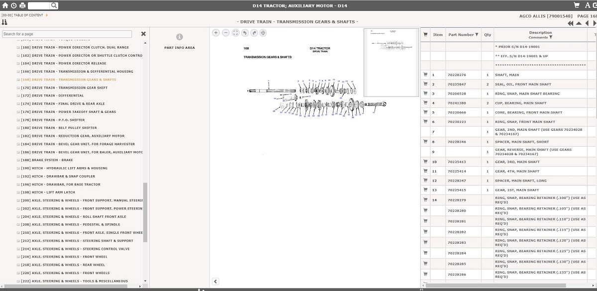

So I was trolling the net looking for AC part #s. I looked at the AGCO site without any luck. I have bearing #s off the ones I removed, but the seal #s aren't giving me any results. I have a I T manual coming but not sure it will have part #s. The Jensons manual I have is ok but not everything that I was looking for.  I will inherit this tractor at some point so I'm not wanting to just cobble it up.

Post Options Post Options   Thanks (0) Thanks(0)   Quote nx08634 Quote  Post ReplyReply Direct Link To This Post Posted: 10 Jul 2020 at 1:36am
I figured out the pictures!

Post Options Post Options   Thanks (1) Thanks(1)   Quote Jim.ME Quote  Post ReplyReply Direct Link To This Post Posted: 10 Jul 2020 at 5:50am
Please explain what you mean by looking at the AGCO site with no luck, maybe someone can help you. The D14 parts list with numbers is there. If you were looking for something specific and didn't see it, knowing what the issue was might get help on solving it. The AGCO site is not one where you purchase parts on line, if that is what you were looking for. You can get the part numbers there to do online searches with and you can talk to a dealer/parts suppliers, using the part number and correct name, when looking for parts. I have found the AGCO website works better with Google or Firefox, than IE, Bing, or Edge.
The I&T shop manual is not a parts manual, it might have an odd part number or two, but not all part numbers. To me the I&T manuals supplement OEM manuals based on the couple different ones I have.
As far as I know a Jensales manual is either a copy of the OEM manual or an I&T manual. I believe the D14 one is a copy of the OEM manual.
Just my thoughts.

Alvin M View Drop Down
Joined: 24 Jun 2018
Location: PA
Points: 802
Post Options Post Options   Thanks (0) Thanks(0)   Quote Alvin M Quote  Post ReplyReply Direct Link To This Post Posted: 10 Jul 2020 at 6:12am
Agco Parts Books .com D14 Than Go To Page 148 All The Part # Are There

Post Options Post Options   Thanks (1) Thanks(1)   Quote jaybmiller Quote  Post ReplyReply Direct Link To This Post Posted: 10 Jul 2020 at 6:14am
you might ( should...) put some wooden wedges at the tierod ends/axle. it'll keep the wheel straight and FIXED.
I found out the hard way they can move real FAST when the back of the engine goes a bit wonky. from 'itll be OK support'.

Post Options Post Options   Thanks (1) Thanks(1)   Quote Jim.ME Quote  Post ReplyReply Direct Link To This Post Posted: 10 Jul 2020 at 6:32am
Jay,
Look close a the top of the axle. It appears to have a block or wedge between it and the casting to prevent tipping.
As I mentioned before the browser you use may make a difference. I found the site works best with Google. Using Bing or some other browsers, I didn’t always get the drawings, it wouldn’t return to the index, etc. You need to look for clutch, power director, transmission, differential or PTO parts. If you were looking for torque tube bearings and seals, they are not listed that way.
1.     On the homepage click on: ” View Books”.
2.     Enter D14 in the model search box. The Book title (D14 TRACTOR; AUXILIARY MOTOR - D14) and publication number(79001548) should appear
3.     Click on the publication number.
4.     Clutch and driveline parts start on page 144 and go through page 174. I see shafts and gears on page 168.

Points: 24703
Post Options Post Options   Thanks (0) Thanks(0)   Quote jaybmiller Quote  Post ReplyReply Direct Link To This Post Posted: 10 Jul 2020 at 9:04am
Yeah I saw them slippery 2by6's but unless tapconned into the concrete(hard to tell with my eyes..), they can move mighty dang fast.....I KNOW a 4by4 'wedge' did !!
safety first....we only have 10 fingers and toes....
