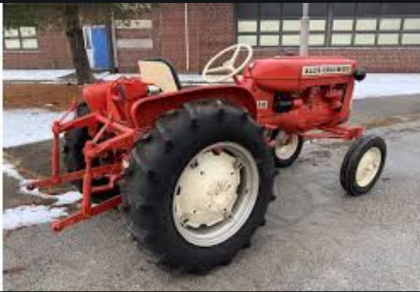

GeneD14
Joined: 17 Sep 2009 Location: TN Points: 254 |
Post Options
Thanks(0)
Quote Reply
Posted: 03 May 2021 at 4:07pm |
uploads/1181/D10_3_point_2021-05-03_16-05-27.JPG
I had a 1960 D10 similar looking to this one that had a factory 3-point. I also had a 1962 D15 with a factory 3-point.
