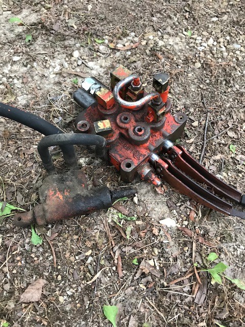

I've been trying to fix these valves for years. The leaks have been a big problem. Now it's bypassing so bad it makes the 3pt hitch impractical to use. It won't hold anything up over a minute or two. I've been told by a couple of hydraulic shops, this is something you can't fix. Once the housing is worn, that's it. I'm not sure if that's true or not, but I don't know what to do for it. There isn't any seals inside. I'm thinking about putting an aftermarket valve on it. I hate to, because I will have to sacrifice the traction booster. I'd like to find one about the same size and appearance so I can try to make it look as authentic as possible.
This is the original valve and traction booster valve. I have a second on the tractor that is not much better.

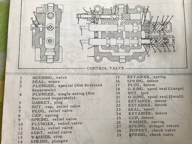

This is the only diagram of this valve that I know of. I've seen it in several books and on line. Most of the parts are NLA. I had new end caps made because that was were my leaking problem was. Of course, that won't stop it from bypassing fluid back into the transmission. If there is anything you can do to slow it down I could probably live with it. Every tractor I have, the lift leaks down over some time, but not like this one. Thanks.

Yes they are a pain and like you, no other parts/controls are like them that I have found.
Do you really need TB? If not then a replacement unit should be easy enough to do.

I've been thru the same thing exactly on my D10 . It is due an overhaul this winter and I have a 2 spool open center valve I plan on putting on it. I ordered it from surplus center.

You could machine the valve body to a slightly larger diameter holes. Then make a new plunger to fit. Not cheap, but would cure the problem. HTH Tracy

Sugestion.Mike area for o rings real good  and compare size with S A E and metric.Metric might work better.Had air compressor at work and pop off valve leaked miked and change to metric and fixed. On relief valve reseat.Took ten thousands off my B and it holds good now.

Can you ream the bore on those?
