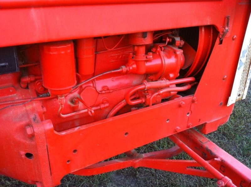

Bought this at the Polk sale in IN about month ago.
D 15LP looks like it has fender side panels.

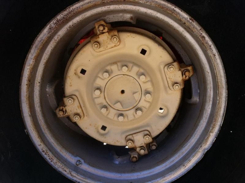

18.4x26 rear tires spin out rims
The brackets will need some pieces weld back into them.
Fenders not the best, but it does have power steering.
When I turn on the LP on it just goes right out the air breather.
Regulator or carb needs attention.

I like those rear rims. Are they welded to make them wider or were the rails put on a wide rim?

They welded the rear rims have not been made wider the inside rail is welded like normal, the rail on the out side short.

   Hey Richard,,,great find on the D15LP,,and a Rice model to boot!! I was lookin at the pic of the regulator and don't know if my eyes are deceiving me,,,?? It looks like the water "in" port is tied together with the gas "out" with that "Y",,,??

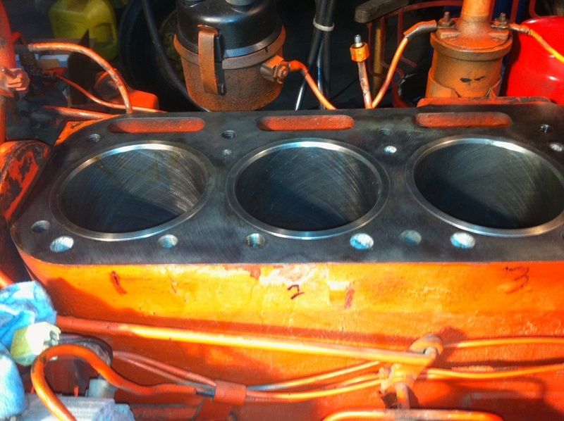

Today after running the tractor in past months some.
Check the compression again today and had 90 30 55 60.
The tractor had been really hard to start but when running does not smoke at all and has good oil pressure.
Removed the head and this is what I found.
valves and seats will need attention.

Warm weather got few things done.
Removed the front axle to allow the removal of the pan.
Pulled all four sleeves today as they had enough damage to them.
Also one of the pistons had broken ring.
Took picture of the lower end, look how clean it is compared to gas motor.
Here is the set up we use for pulling sleeves when the block is still in the tractor.
My Dad had made the plate just little under size of the sleeve.
To help we use slide hammer at the top.
