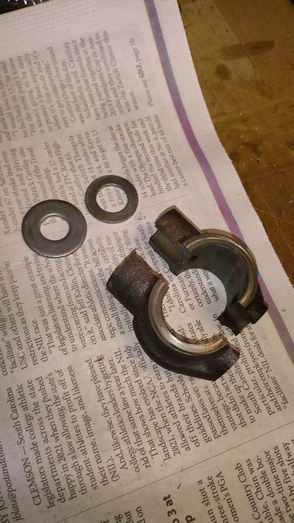

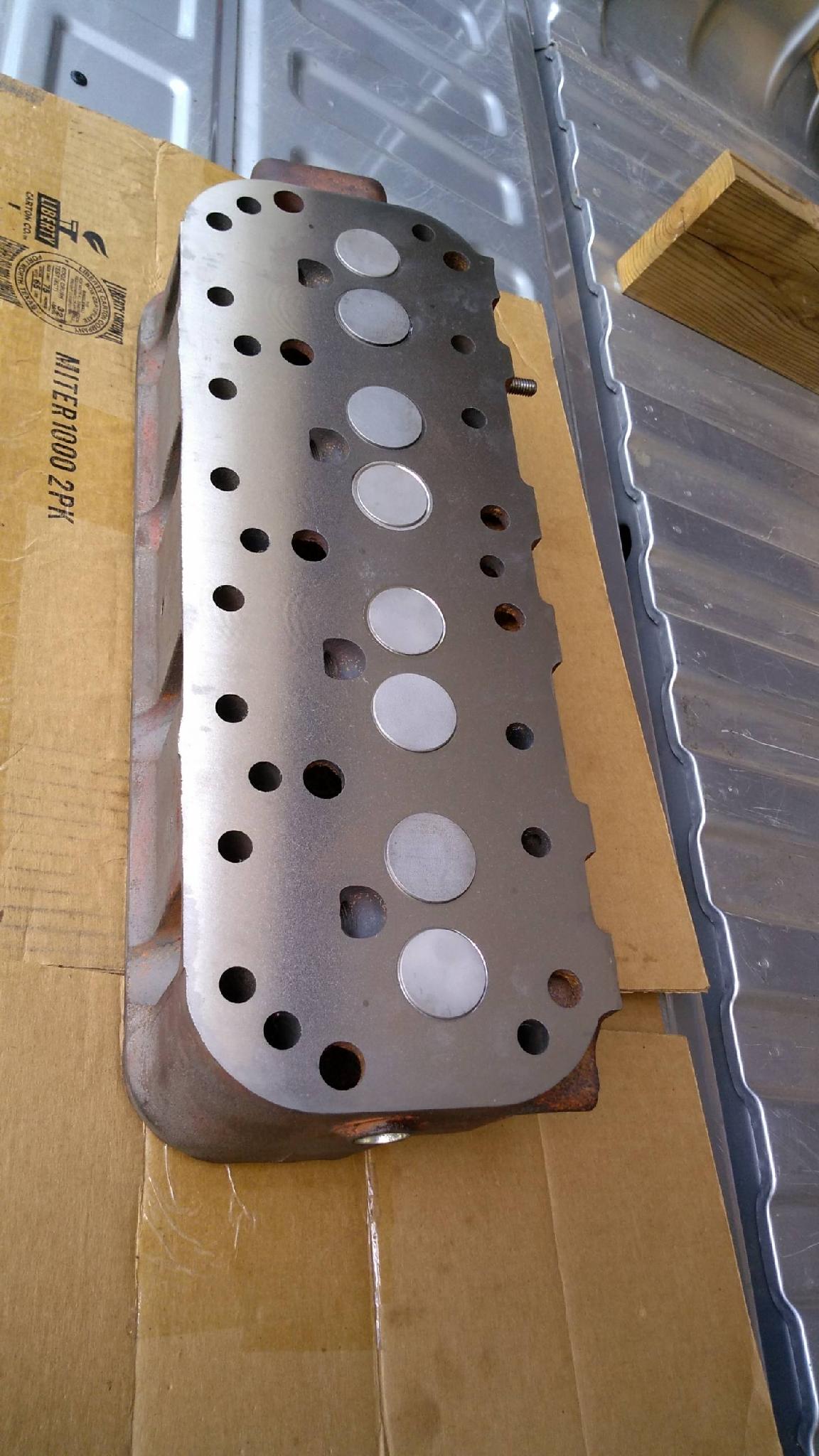

Back from the machine shop . They found 2 stripped bolt holes that they fixed . Also a bent pushrod and a broken rocker arm support . Brenda at Sandy Lake to the rescue on them . Sad thing is when I put it all back together and pressure test the cooling system I may still have coolant in the oil . Oh well . Fav son should post pics soon .

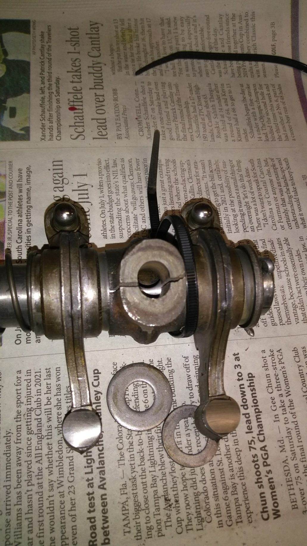

Post Options Post Options   Thanks (0) Thanks(0)   Quote WeisAC2 Quote  Post ReplyReply Direct Link To This Post Posted: 01 Jul 2022 at 7:22am
Location: Gallatin,TN
Points: 10735
Post Options Post Options   Thanks (0) Thanks(0)   Quote Tracy Martin TN Quote  Post ReplyReply Direct Link To This Post Posted: 01 Jul 2022 at 5:26pm
When tightening down of loosening the rocker arm, make sure you do it evenly, not all at one tower. It will help out. HTH Tracy

Thanks Tracy I'll keep that in mind. I'm thinking that support was broken the last time someone was in there. It had those 2 washers under it. Not sure why? That stud was also slightly bent. I'm guessing that's where the bent pushrod came from? Thanks again

Do not over tighten rocker hold down bolts. That is what brakes the stands.                         MACK

Thanks Mack , I'll torque them to 20-25 lbs like my service manual says . A little at a time like Tracy suggested .
