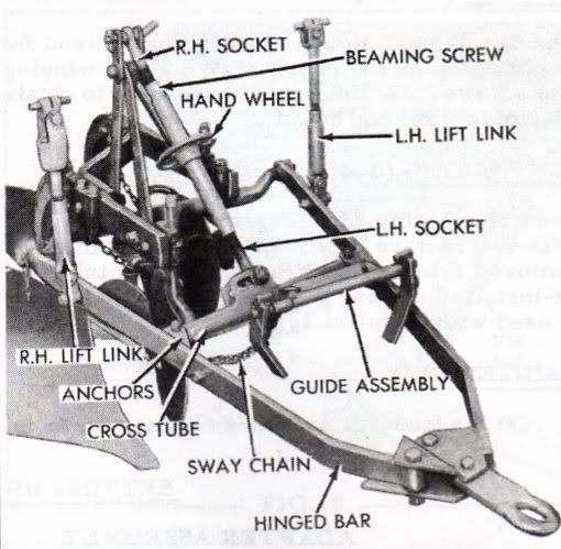

Back 'in the day', AC made an implement adapter to do just that, convert common 3-point implements to snap coupler.  Cross still makes a very similar adapter that could be modified to do the same thing.
This is from an old AC manual and shows the adapter mounted on a 3-pt. plow:

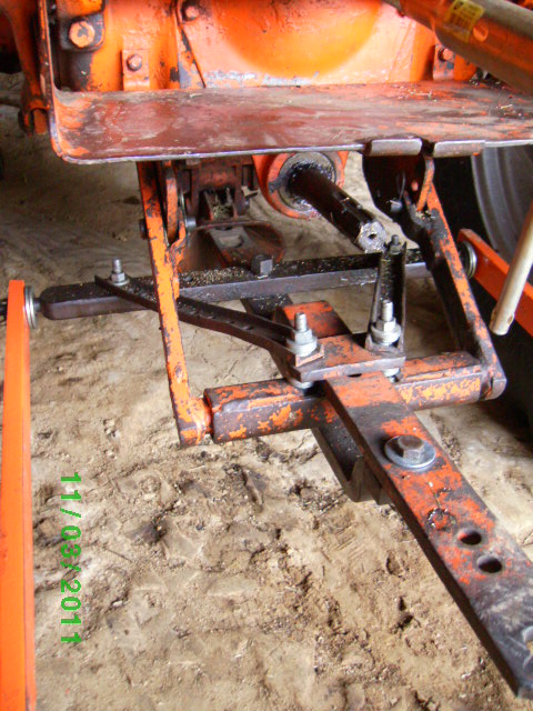

I use 3 point implements and Snap Coupler implements all the time on my WD45 and I don't have one of those bulky expensive 3pt conversions. When I want to use the Snap Coupler I simply drop the drawbar like  normal.
l'll try to get a better pic tomorrow, in this one I have the lift arms off(with a flip of the safety latches and the lower pins, lift arms come right off. They are off in under 2 minutes....they can be left on but it makes the drawbar easier to get back on b/c its lighter without them. Heavy duty bracket is welded on to the lift shaft for the center link. With the boom pole on I have lifted the rear end of another WD45 with no problem.
 Those aftermarket hitches are so freaking big and not easy to remove.....the set up I have is sturdy and simple......works great.....Grandpa made a living with this tractor setup this way.

Post Options Post Options   Thanks (0) Thanks(0)   Quote 79fordblake Quote  Post ReplyReply Direct Link To This Post Posted: 02 Nov 2011 at 11:33pm
Sorry guys I forgot to take a pic of the setup while I had the tractor out today.....I have no problem doing anything heavy duty with this setup.....I used the boom pole today and picked up the whole back half of a 1975 F100 truck so I could get the rear end out from under it.
I'll try to get a pic of it tomorrow. I need to straighten one of my lower arms....I bent one backing the pond scoop into hard ground a few years back.

Post Options Post Options   Thanks (0) Thanks(0)   Quote 79fordblake Quote  Post ReplyReply Direct Link To This Post Posted: 03 Nov 2011 at 1:33pm
There we go...I didn't forget to get pics today lol.

Thanks for the pics!  It always seems like the ones you make yourself at least seem to be better (probably just the pride of doing it yourself).  Looks like a good and fairly easy setup to fab.

Thanks 79Fordblake. I understand now. no problems with that set up ? humm looks good.

Post Options Post Options   Thanks (0) Thanks(0)   Quote 79fordblake Quote  Post ReplyReply Direct Link To This Post Posted: 03 Nov 2011 at 11:26pm
This setup has been on the tractor since way before I was born and I am 21. I use it constantly lifting very heavy things with the 3pt boom pole....use a bushhog, regular blade, box blade, cultivaters, pond scoop, and disk also with no problems. I have good lock washers on all the bolts...this thing is rigid with no movement.
It makes it so easy to drop the drawbar like normal and hook up snap coupler implements.
