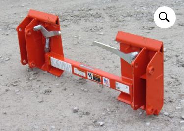

I know Steve Fischer had some plates built for it a few years ago.  I have also sold some Notch brand plates that were blank and the owner welded mounts on to the back of it.  These are all skid loader universal plates.  When you go to the skid loader plate it opens up a lot of attachments that you can put on your loader.

I am currently going through the same process with a 400 series loader. Plan to get the latch boxes and weld cross peices to space the boxes correctly and weld pivot pin hole plate to the back side.

We got ours for my 460 loader thru the dealership. There is a Shortline bucket company that makes them. Less than $1500 if I remember correctly. My bucket was shot thru so it was cheaper than getting a different bucket. Now I can use all the Skid Steer stuff.

Built my own for a 715B TLB 30 years ago using a forklift plate on the loader.

Just my opinion; make the QT to fit skid steer accessorizes.  that way you can buy, borrow or rent any kind of bucket needed!

Contact the folks at Worksaver in Litchfield Illinois, they make ready to go adapters and many attachments for loaders and skidsteers of most makes. Made in USA and they ship globally. Goto their website or call them at (217)324-5973. I have gotten several items from them over the years.

If you can Google Notch MFG Inc you can see their attachment plate.

all kind of Bobcat plates on e- bay....
i bought a couple to install forks and bush hog on a Bobcat.
