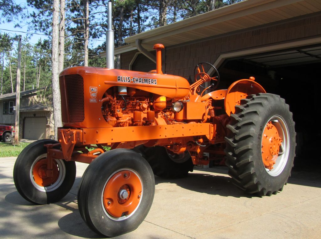

In 2007 it was $127 plus shipping which made it $140.  Here is a link that shows when I first got it.  I had a clamp to a bracket for the two bolts, but the hood would not fit as the clamp had to be too high.  I had the bracket welded to the under side of the pipe where it was reduced down for the inlet; then the hood fit nice.
http://home.comcast.net/~old_allis/ac-wd45d-final.html
I have since bought a Nelson muffler for use at the farm since it is so loud to have the straight pipe on when working.  The muffler cost $164.43 and with tax and shipping it came to $189.70; so either it was inflation since the muffler was purchased in 2012 or the straight pipe was cheaper.

The Nelson muffler is taller than my other pipe; I ordered the straight pipe at a height that would fit under the garage door.  I had to move the 45 to the other side of the shed with the 12' door now since it no longer fits where it was.  I measured first though so I drove it out before putting the muffler on; otherwise I would have had to install it twice.
