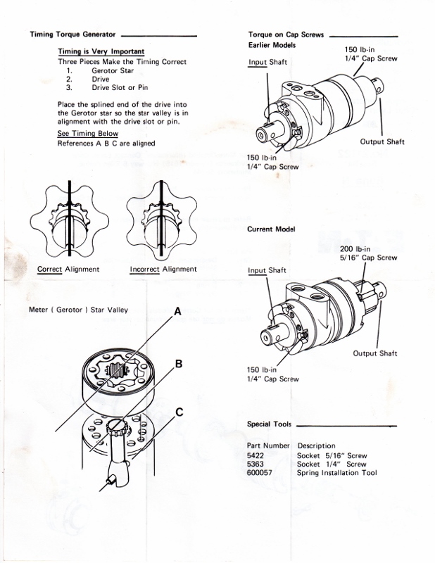

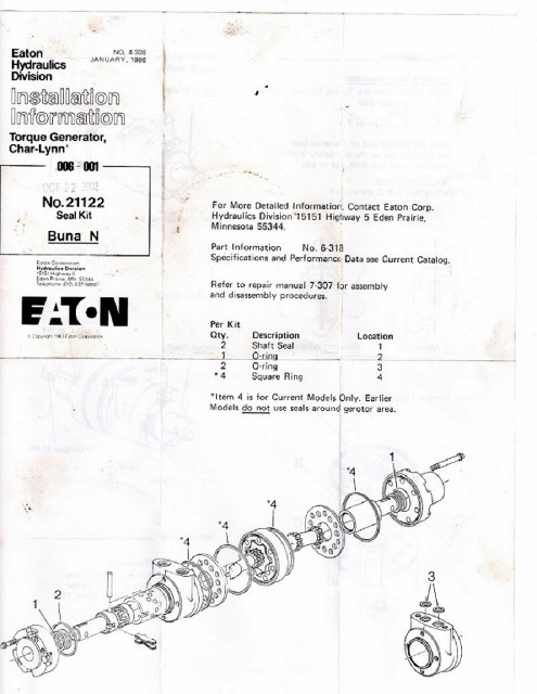

Try this
Eaton power products
No.21122
I ordered this from Force America several years ago, its a complete seal kit, with instructions on how to "time" the gears..

Post Options Post Options   Thanks (0) Thanks(0)   Quote mhankins Quote  Post ReplyReply Direct Link To This Post Posted: 10 Nov 2020 at 8:44am
HELP!!
 Ok,finally got around to taking the multiplier off and replaced the seals,butt...
when I tighten everything down it will not turn. I timed it according to the pics above and tried the spacers in each position.The coupler shaft that goes between the rotor and the out put shaft at the lower part has different thickness splines on either end and I have tried those in each position.
 This is a series 101 which shows a little difference than the one pictured as to how many seals are used as mine doesn't have the larger orings sealing the case and spacers.
 Any Ideas?
