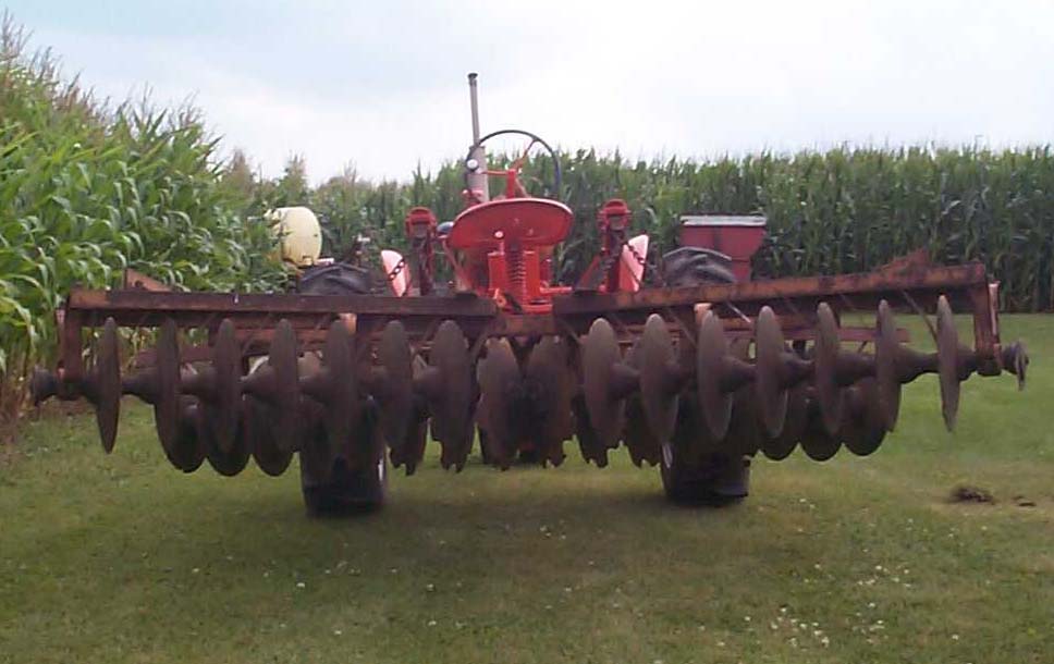

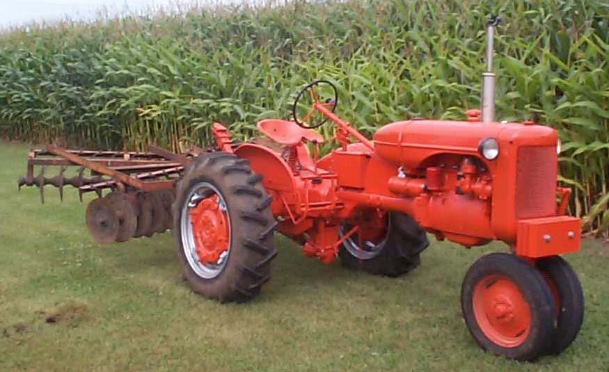

Here are a few pictures before I added wheel weights. Look at the front of the "CA". I bolted three 50 pound home made weights to the front.
"CA" Disc Video
Thanks & God Bless
Dennis
