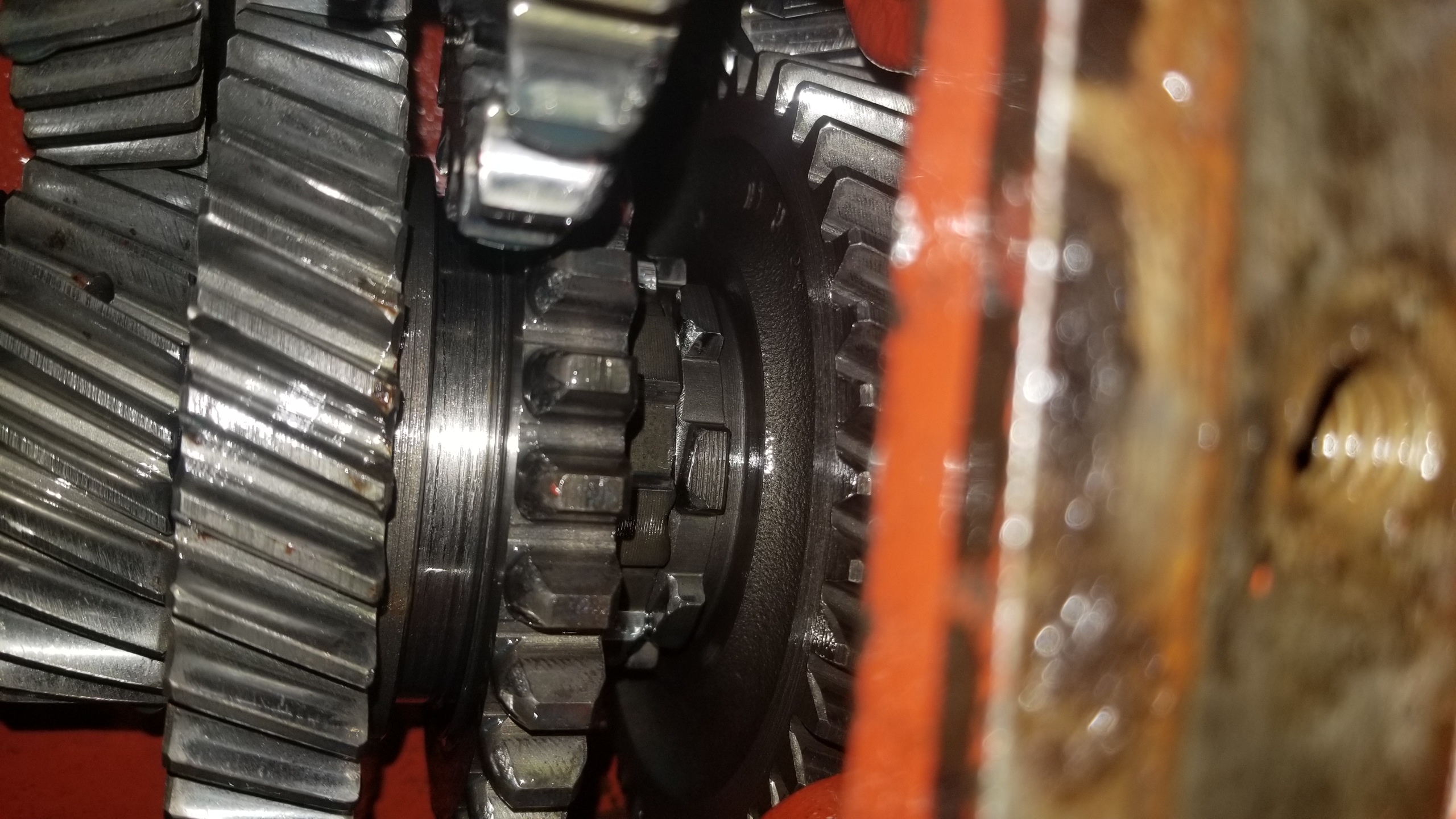

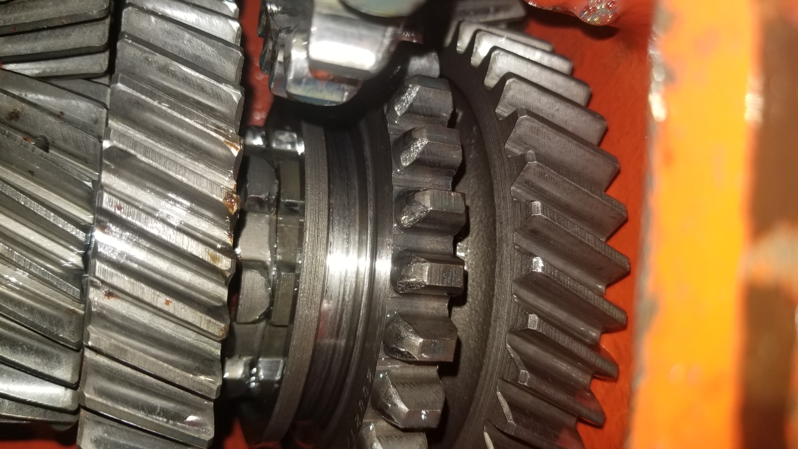

What do you think of this ?

I can't detect any front to rear movements in the gear

That’s pretty bad. Replace or repair the gear and coupler.
If you just replace the coupler the gear will start working on the coupler and shorten it’s life.

Looking at the picture everything was fine till I saw the lug.  Must be replaced.  Anything else is temporary.  It is so much trouble to get there you may as well replace the gears and collars Randy mentioned.  Pricey but necessary
We could never get operators to NOT SHIFT on the go.  Chewed up the transmission.

If I were going to do a tear down I would replace all three parts. 2nd, 3rd, and sliding coupler/reverse gear. Can't see amount of damage to internal splines of coupler in pics. But can see contact area on 3rd gear splines and it looks to me like your detent position wasn't right to begin with. Even with the damage you have it might be worth it to see why it appears not to be engaging all the way. 2nd gear look good on engagement and it has more damage. (To much gear grinding huh) but I take it that its not jumping out of 2nd ??

Need to correct part of what I said. 2nd gear damage is not worse. 3rd gear is. Engagement wear point looks short of where it should be on 3rd gear is my point.
