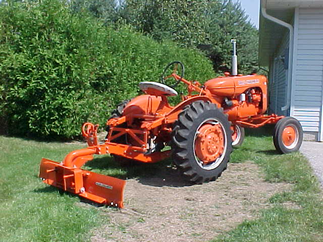

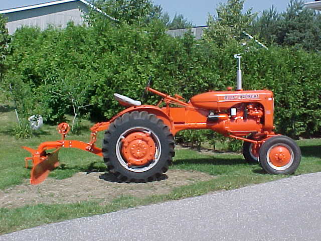

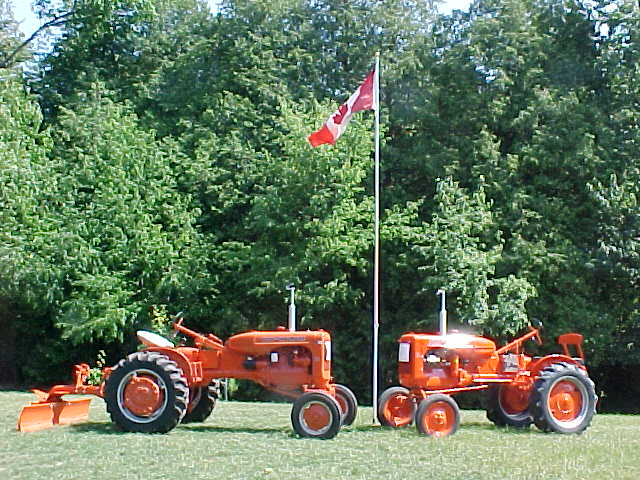

Post Options Post Options   Thanks (0) Thanks(0)   Quote Ross D. Quote  Post ReplyReply Direct Link To This Post Posted: 29 Oct 2017 at 12:26pm
Hi.    Hope the picture size is O K.
Ross D. View Drop Down
Joined: 02 Sep 2013
Location: Erin, Ont.
Points: 339

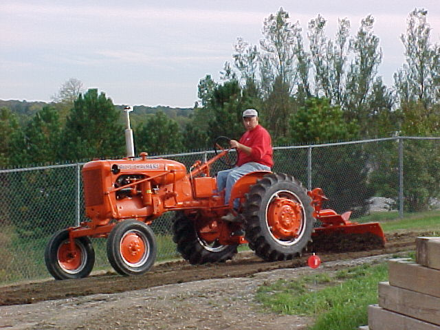

Post Options Post Options   Thanks (0) Thanks(0)   Quote Ross D. Quote  Post ReplyReply Direct Link To This Post Posted: 29 Oct 2017 at 12:38pm
CA and blade in action. Great combo.   R.

Beautiful CA and B Ross! Dad has cultivators, belly sickle mower, 2 bottom plow, but is currently running a L306 belly finish mower. Great little tractor. A blade like that would be sweet. Also has a 3 point snap coupler setup with it.

Really cool pictures of CA's at work! I have the Oxnard rear blade, nice to know it will fit my CA. Really cool picture of the CA crane, is that factory or homemade? Right now I have my mower on mine but with winter coming I think I'll take it off so I can use my blade if it ever snows. Thanks for all the pictures, good looking tractors and implements!
