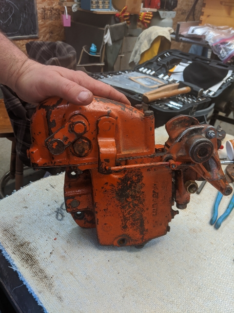

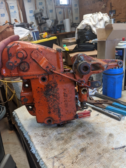

Well that was fun. It's all cleaned with new o-rings and a couple other worn parts replaced (including the two cotter pins that had fallen out inside the drawbar control linkage)
Now just two get it put back on tractor tomorrow with new hydraulic trans fluid and hopefully everything works as it should. I was a little apprehensive to do this but I think I did okay because at the end I didn't have any spare parts on the bench πŸ˜‰
Here's a couple of pictures of it all back together although it doesn't look like very much from the outside there's a ton of parts inside of one of these that I hopefully will never need to mess with in my lifetime again.
Thanks for everyone chipping in information in the process, Matt πŸ‘

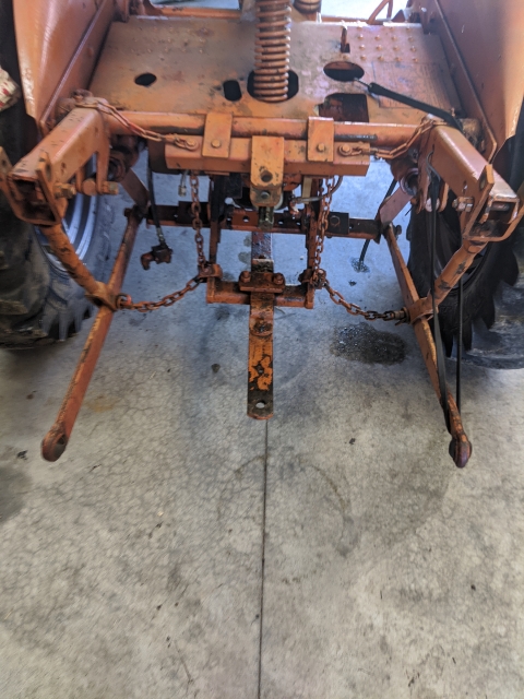

Post Options Post Options   Thanks (0) Thanks(0)   Quote Ted J Quote  Post ReplyReply Direct Link To This Post Posted: 05 Apr 2020 at 11:50pm
You're doing just great Matt.  I can't help you with the loader on one of these, as we never had a loader on one of em.  We always had em on the WD or the WD45.  Only had the cultivators on the CA.
Nice set up of the 3-point also.  This is one of the handiest little tractors and it has a lot of guts and power and doesn't hardly use any gas...
