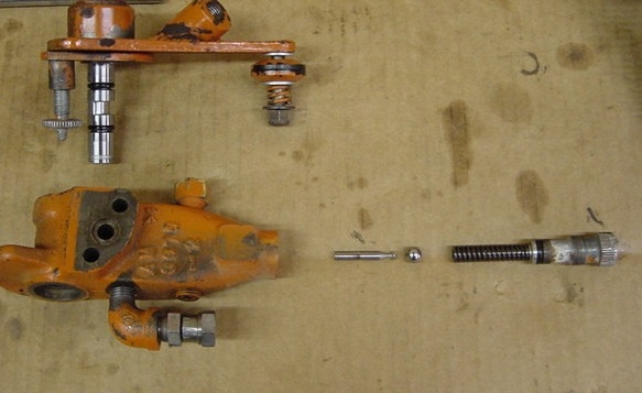

My hydraulic pump on the CA works, but won't release.  I pulled it apart and cleaned it and noticed that the plunger is missing.  Anybody have a parts tractor I could buy this plunger off of?  It is part number 224894 and shown in the picture below.  It's just to the left of the ball.

I could be wrong, but I thought someone on here said the internals of a CA pump are the same as a WD & WD45. That might make the search for parts easier.

AGCO has a kit with all the replaceable parts in it for the "HOLD VALVE"

you can still get the plunger from ACCO. I ordered one this past fall
