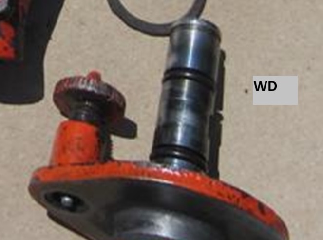

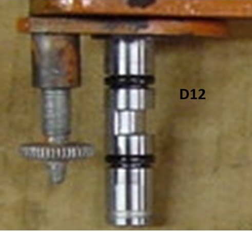

Post Options Post Options   Thanks (0) Thanks(0)   Quote dfwallis Quote  Post ReplyReply Direct Link To This Post Posted: 16 Sep 2024 at 6:29pm
This image includes a side view of the CAM:
It appears that the low spot in the CAM is pretty much directly opposite the lock screw position.  I'm not quite certain though that I can fully view the proper perspective in the image.

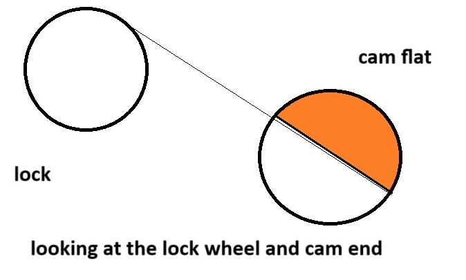

Post Options Post Options   Thanks (0) Thanks(0)   Quote dfwallis Quote  Post ReplyReply Direct Link To This Post Posted: 16 Sep 2024 at 6:35pm

Post Options Post Options   Thanks (0) Thanks(0)   Quote dfwallis Quote  Post ReplyReply Direct Link To This Post Posted: 16 Sep 2024 at 7:03pm
After further review, aligning/matching per the CA and WD images seems to agree with my initial marking give or take a few degrees.  Is there any reason for the CA and WD alignment to be different (the perspectives are still a little difficult to be 100% certain).
Edited by dfwallis - 16 Sep 2024 at 7:05pm

Post Options Post Options   Thanks (0) Thanks(0)   Quote steve(ill) Quote  Post ReplyReply Direct Link To This Post Posted: 16 Sep 2024 at 8:53pm
Gary... i hope im not confusing you more, but i blew up the photos and they do look similar... like you said, the angles are deceiving and i could be wrong... it is  deceiving bacause the WD photo is taken from the back side..

dfwallis View Drop Down

Post Options Post Options   Thanks (0) Thanks(0)   Quote dfwallis Quote  Post ReplyReply Direct Link To This Post Posted: 16 Sep 2024 at 9:37pm
