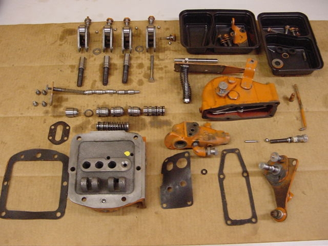

Does anyone have pictures they could post of disassembling and rebuilding a CA hydraulic pump? The exploded drawings in the service manual don't show a whole lot.

Glad I'm not the only one who thought the 'manual' was incomplete. I took a lot of picture before I tore mine apart,found out WHY a good clean well lit bench is necessary, especially a lip on the back. Had one of the check balls 'roll' onto the floor, 2 hours later found it...
I do remember the 'guts' of one of the pressure relief valves( up front) wasn't clean.Took me 3 tries to do it right,but once everything was clean the pump and valves performed great.
I'll look for the pictures and any papers I have, PM me to remind me in a day or so.

Hello, I am rebuilding a pump now, do you still have the pictures?

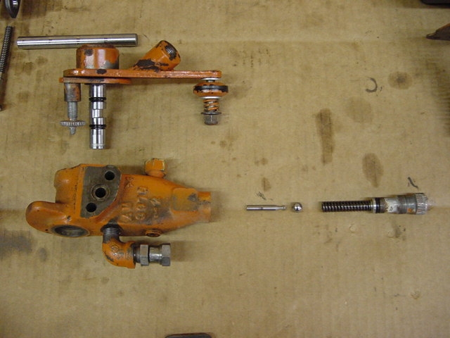

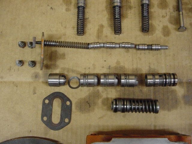

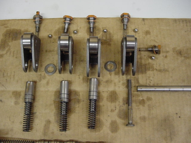

Post Options Post Options   Thanks (0) Thanks(0)   Quote wkpoor Quote  Post ReplyReply Direct Link To This Post Posted: 02 Jul 2011 at 9:12pm
Here ya go!

Very nice Bill!

Excellent Pictures.  Again on my computer.
Remember, the CA and the WD-WD45 pump are the same.  Just in different locations.  Also, remember that the CA pump can be idle if the PTO is not engaged.  We found stuck pistons because of it.  May be wise to run it from time to time.
As said above be very careful.  Use a clean bench with edges on it.
Remember, If I can do it I know you can.
Good Luck!

Post Options Post Options   Thanks (0) Thanks(0)   Quote kmckemy Quote  Post ReplyReply Direct Link To This Post Posted: 06 Jul 2011 at 8:11pm
Thanks for the pictures, it is back up and running now.

Can anyone tell me if the Plungers that go under the 4 rollers get o rings in the 2 grooves they each have?

Post Options Post Options   Thanks (0) Thanks(0)   Quote jaybmiller Quote  Post ReplyReply Direct Link To This Post Posted: 04 Aug 2021 at 8:28am
No o-rings, as far as I can remember.....
if 'similar' to D14, for sure NO orings.....
