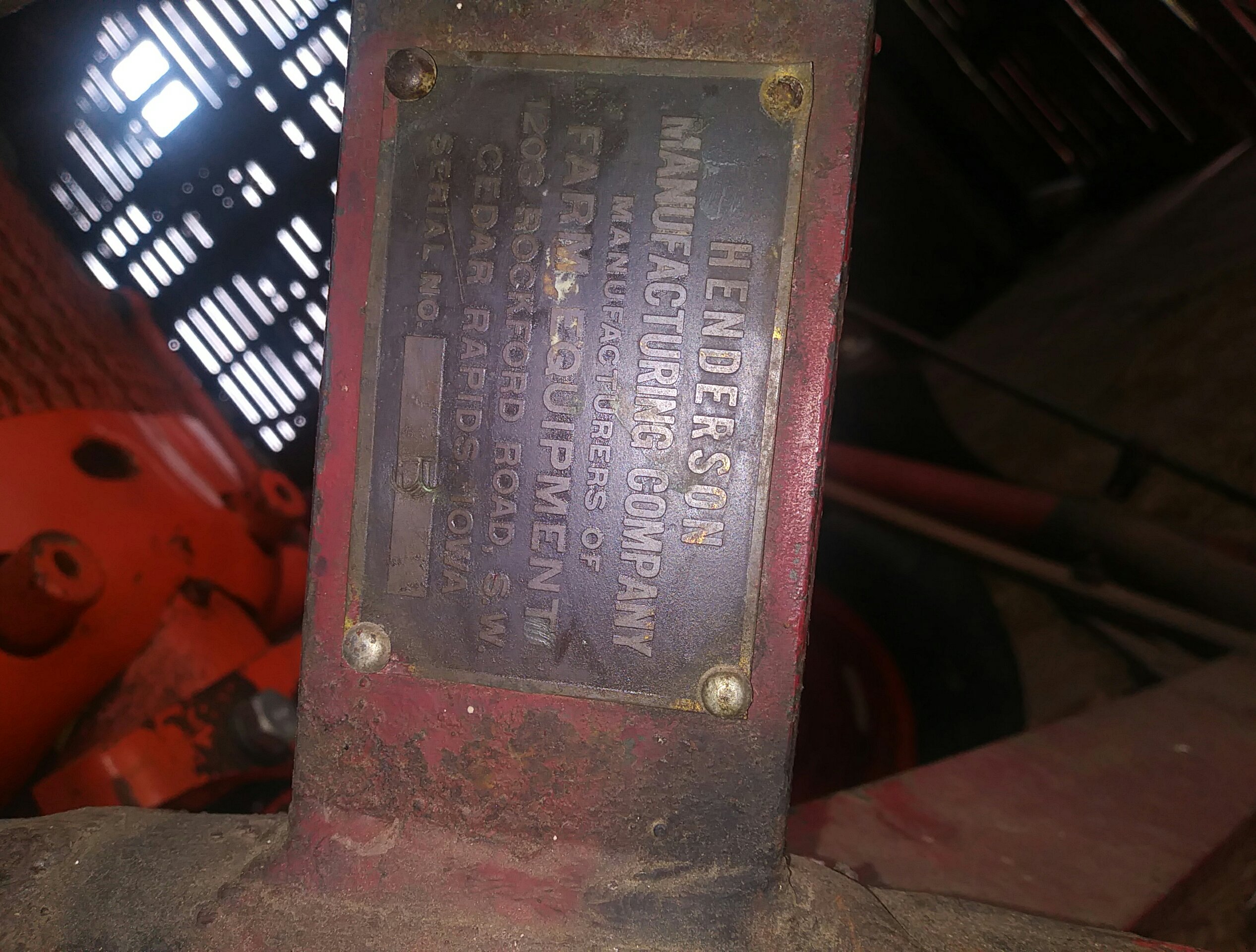

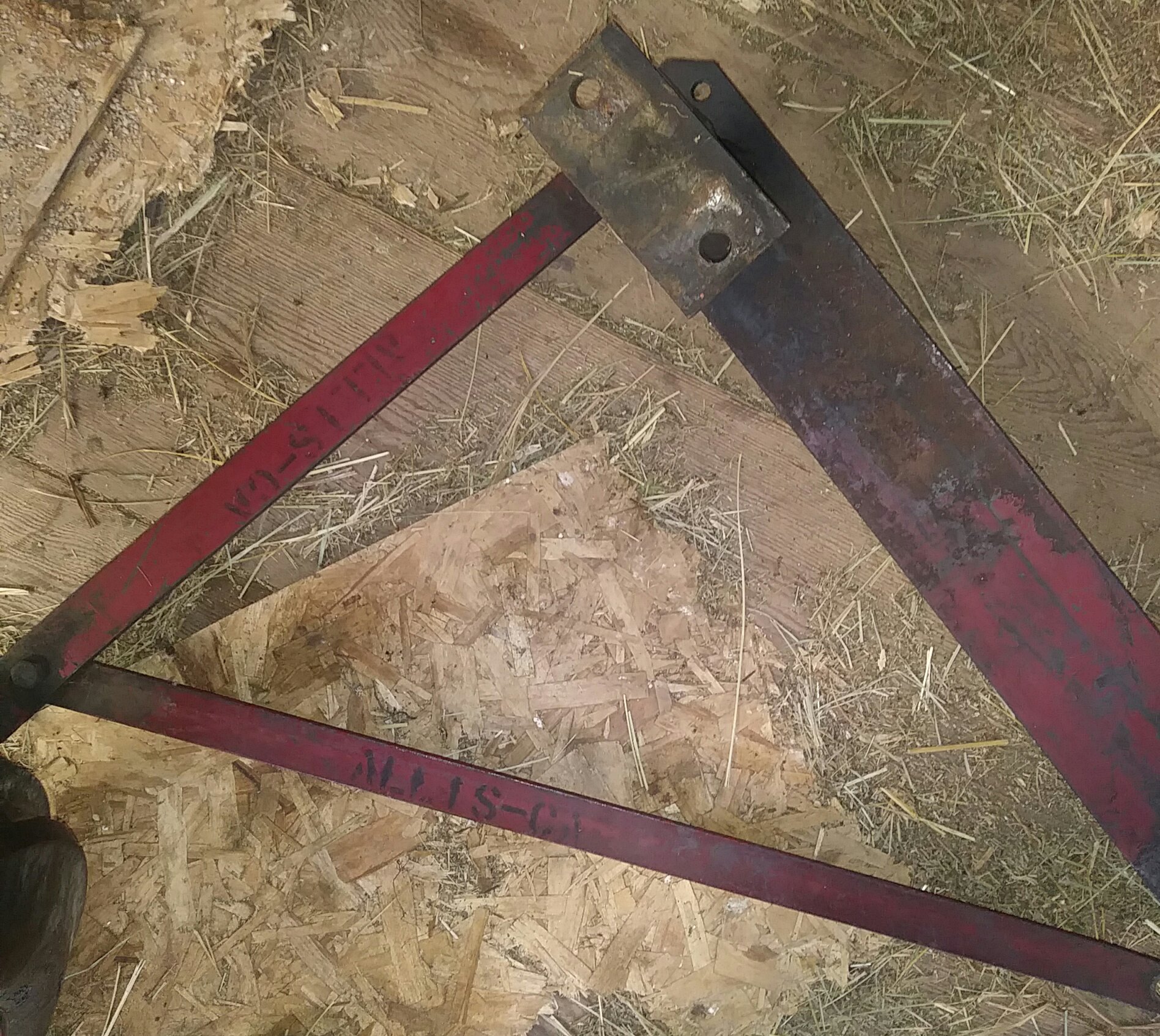

Yesterday I purchased a loader from a member of this site, Rog NCWI, who lives just a few miles away :) Its a Henderson loader serial number "8" or "B" (hard to tell...if it's "B" that is stamped backwards and twice on top of itself). It appears all factory. Has some stenciling that says "allis ca" on the tube frame. The Henderson dark reddish paint looks original too.

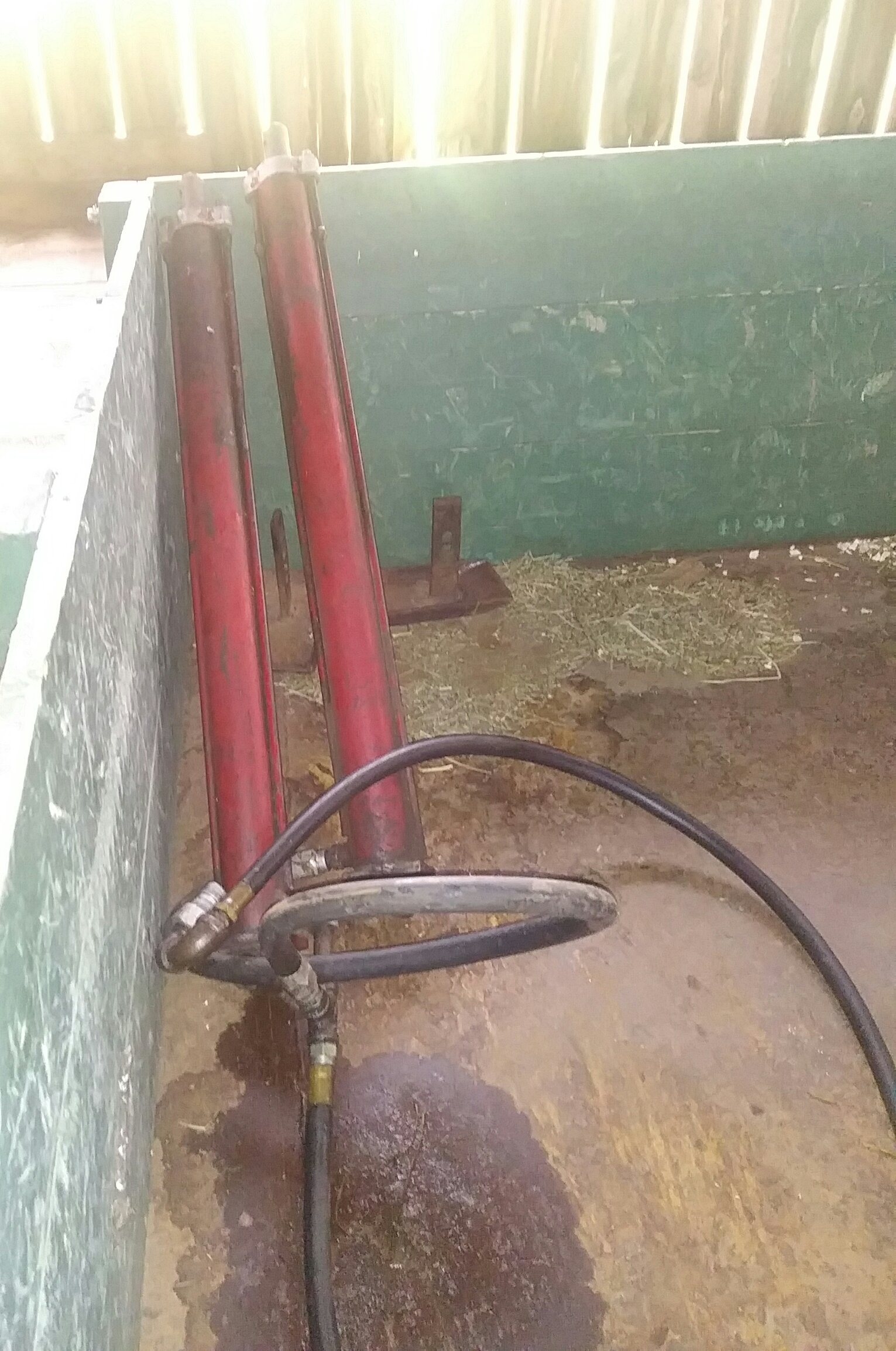

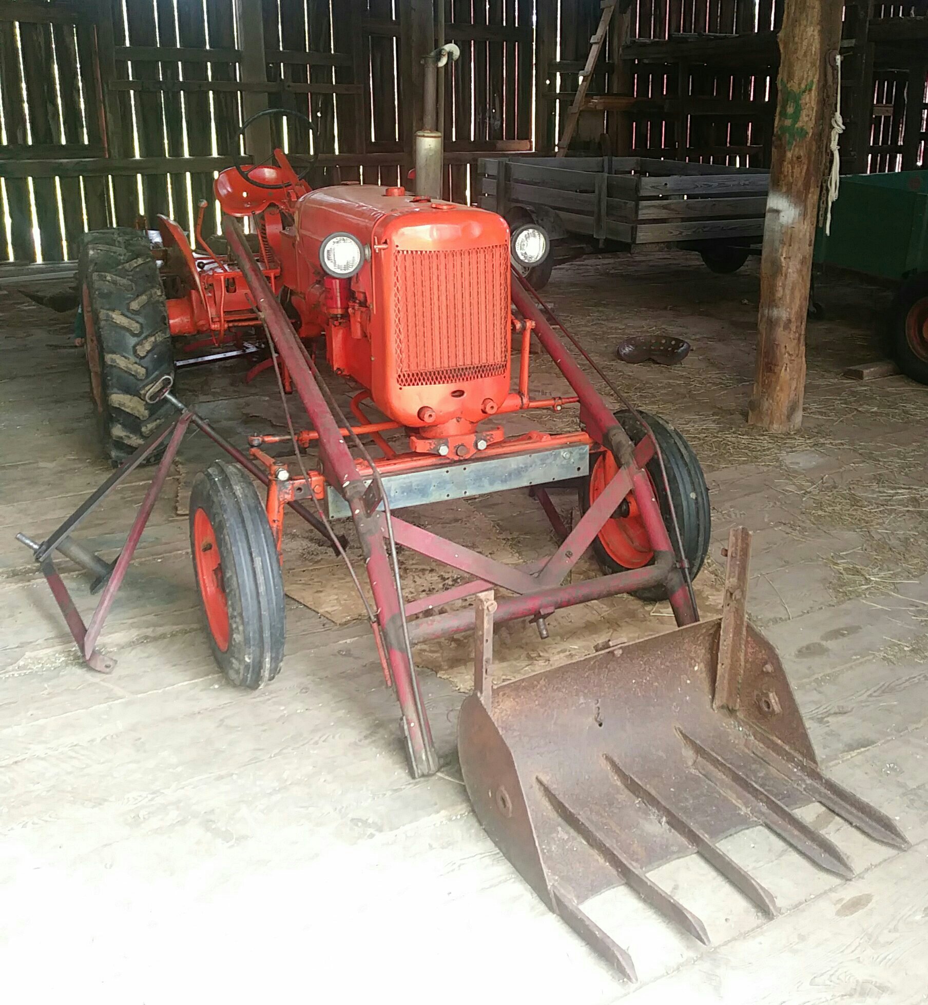

Finally got around to unloading the loader from the trailer and laid out nice for some pics.
Won't be mounting it till I get some new hoses made up. All the weight will be on the bell housing and front attaching point under the radiator. Not sure how much I care for that...Will just have to be careful how I use it. For snow removal and the light work it was designed for it'll be alright I think.

Anyone have a Henderson for their CA? Seems they are somewhat common for B's which then have to use an auxiliary pto mounted pump for the rams. The CA has a hydraulic auxiliary port behind the seat which Roger said is where this was hooked up from the guy he bought it from. Will I have any issues to watch out for with pressure when it does get hooked up?

I have one I took off a CA that I never re mounted on anything. It does not have the round pipe frame though. I was going to mount it on one of my B's I think mine mounted on the foot bar rather than the bell housing. Not sure of that until I look again. I have it scattered all over now. I don't have the bucket.
